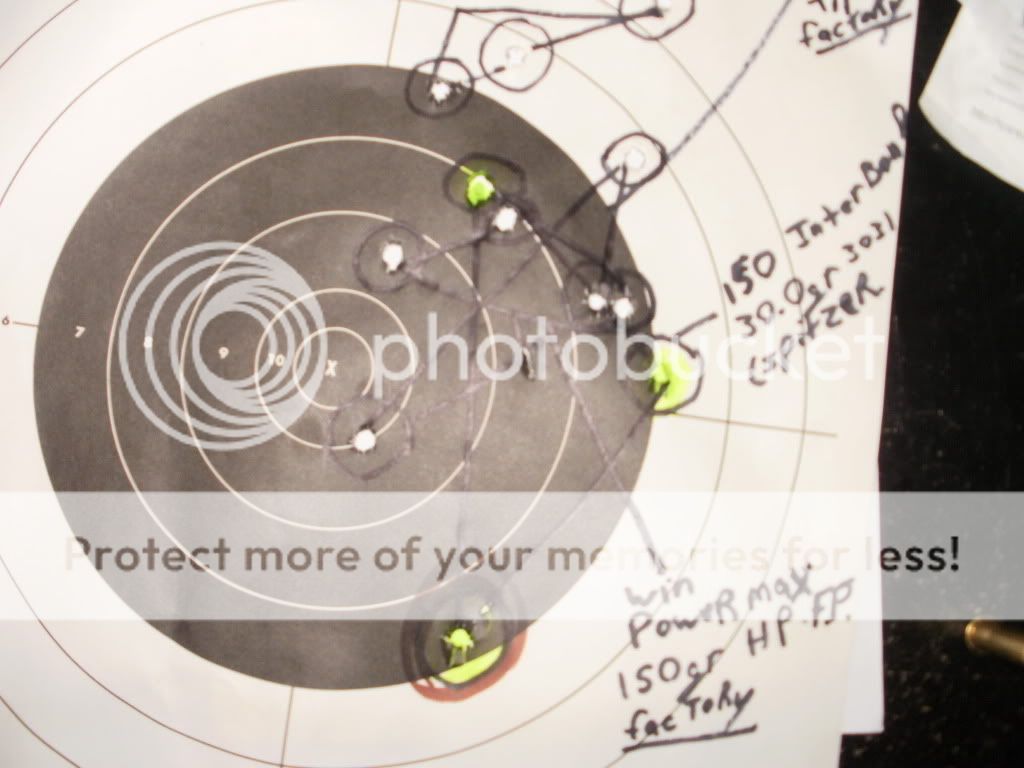

well i have just got back from the range and took pictures of my targets.i have measured out from ctc using a digital caliper. all tagets were shot at 100 yards i will post the pictures up in the best to worst order. you may be surprised(i sure was).i didnt take any pictures of the tracers as i was just testing to see if they would light.(shamefully they didn't i have a video i'll post of the 30-30 and 30-06 tracers at the bottom of the page.

Hi Ken: If you're seriously interested in shooting the M 94 you really should read Sam Fadala's book "Winchester's .30-30, Model 94". Lots of history, loads etc. Plus a chapter on tuning the M94 for accuracy. The "tuning" really works too. Not that my M 94 is a tack driver but it will put 3 shots from a rest into 1 1/2" to 1 5/8" at 100 yds all the time.
How fast are you shooting your groups?
Most of them look like two shots almost touching,
then the third is off in left field, once the barrel is hot.
Three of those 125 Speers from a cold barrel look like
you could cover them with a dime.
