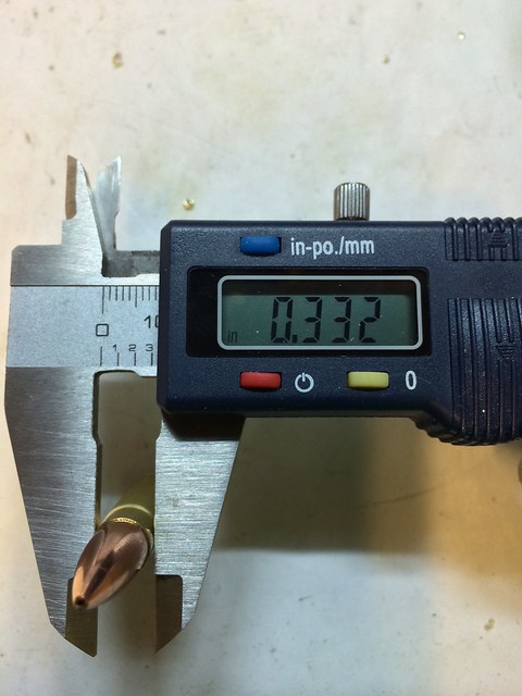

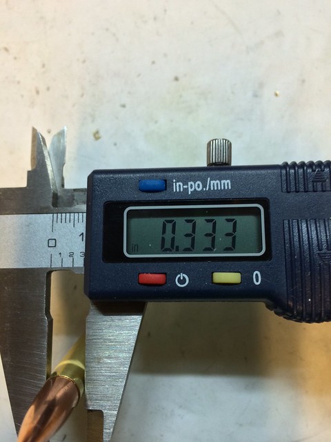

With a bullet seated and lightly crimped, my previous measurements in earlier posts shows 0.332" to 0.333". Here's a couple pics.
