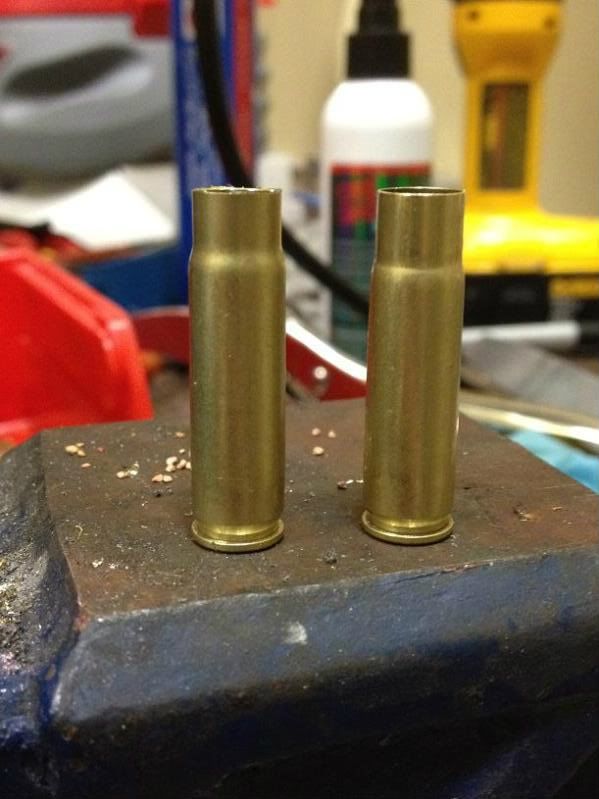

I have the trimmer set up to trim to 1.355", and the shoulder is not completely formed. Full length sizing is done on station 5 where the shoulder is finish formed and the case grows a couple thoushands to about 1.360"
The finished case is on the right.

I can do about 500 cases per hour, but I still have to polish and deburr the necks
After 2 hours in stainless steel they look like this.
