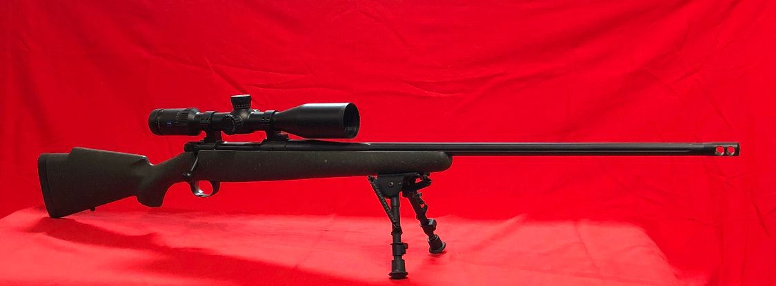

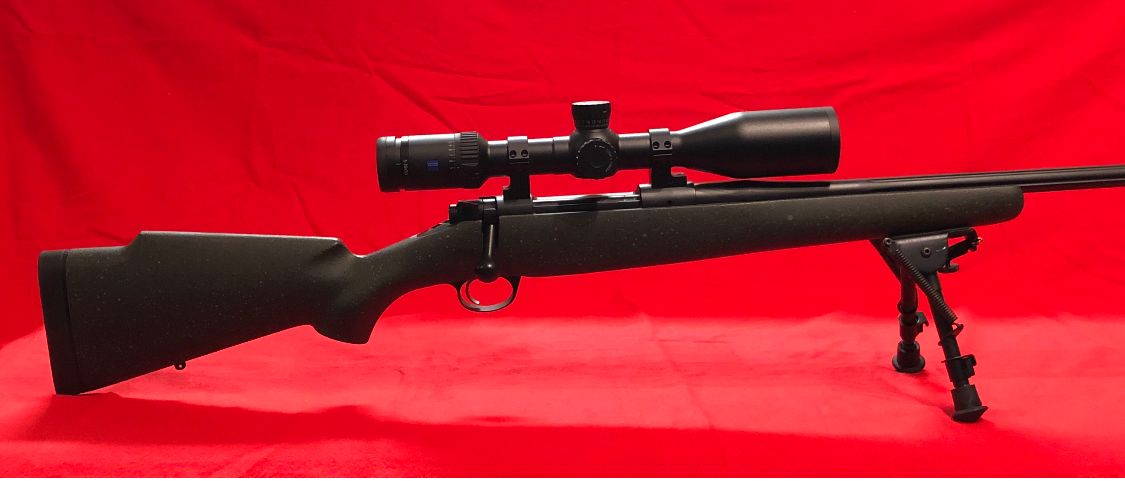

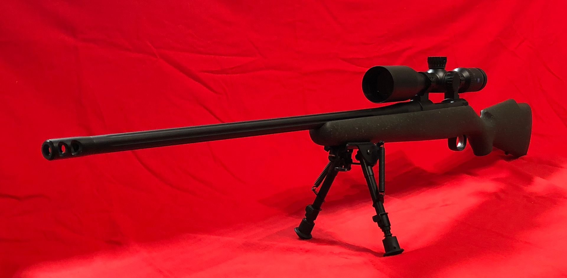

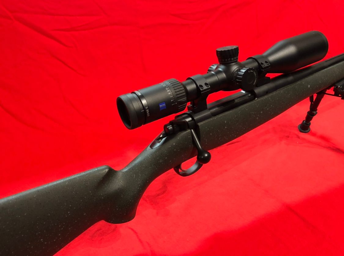

Here's my new 300 PRC built by Gary Flach, very similar to the first one built,
Kimber Montana 8400 (300 WM donor) 300 PRC, action trued & squared
Factory trigger lightened to 2.5 lbs
26" SS #4 contour 1-9.5 twist 5R Benchmark Barrel, 2 port brake added
High Comb and Palm Swell added to the Montana stock
Dark Green paint on the stock and Black Gunkote on all metal surfaces
Talleys holding a Zeiss V6 5-30x50 ZMOA scope, scoped rifle weighs 9lbs 1.5oz
