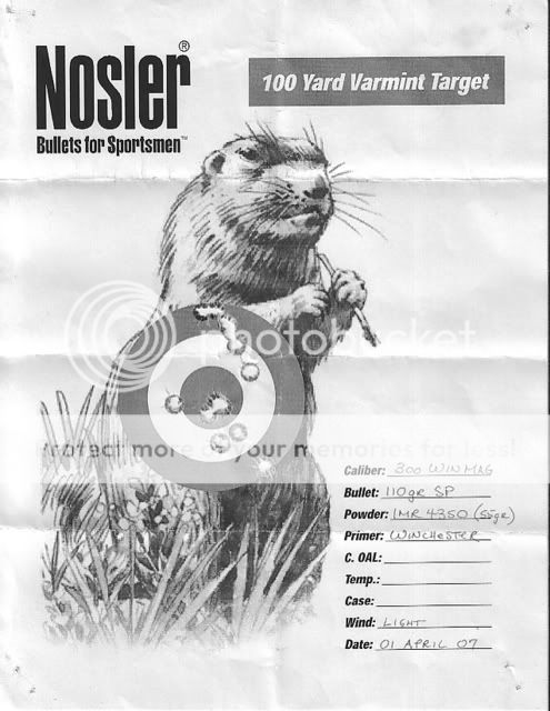

My 300 Win Mag Varmint Load
Rifle: Savage Model 111 - 300 Win Mag w/AccuTrigger
Scope: Barska 6x24x50mm
Reloaded with Lee dies on Lee Anniversary press.
Bullet: Hornady 110gr SP (Spire Point)
Powder: IMR4350 @ 55gr
Primer: Winchester Large Rifle
Brass: W-W
Target: 8 1/2"x11" Gopher
Distance: 100 Yards
Wind: Light
Shot from bench with sand bags.
This load is between a .308 Winchester and a .30-06 following the reduced loads guide in the Lee Reloading Manual. Recoil is VERY light and you can shoot 100 rounds without dislocating your shoulder.
