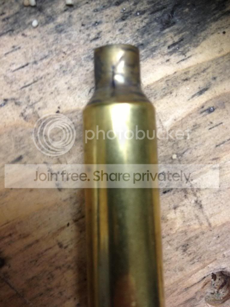

My friend has a 300 wsm. He is no where as anal about his stuff as I am. Leaves his action open while driving around, collecting dirt and what not.
He has about 150 brass pieces for his rifle. He left them by my tumbler cause he didnt know how to work it. So i tumble and then inspect them for him. Turns out 90% of the winchester brand brass, once fired, have long cuts in the neck. So after seeing these obvious faults i looked at the rest of his ammo. Mostly fusion brass, and they all have 4-5 little nicks right before the shoulder.
So heres the problem, we live together and he wants me to help reload some ammo for him. He just bought some dies and all the components for my press. I dont know if im comfortable using these nicked cases. The only thing i can think of is that the Winchester brass is garbage and the same nicks ended up as large holes in his Winchester brass. Id rather not do anything even if it borders on dangerous.
here is a pic of a winchester case that has been wrecked in his rifle.
I will get better pics of the wrecked ones and the ones he intends to reload. He is taking his rifle to a smith at the end of the month but im more concerned about the reloads since ill be basically doing it.
seems to be a winchester problem in factory brass , loaded near max or at max , with brass like that i would be tossing and getting some fresh brass , and maybe try a couple manufactures remington and federal brass
they were factory loads that did this. The fusions didnt do this but they have slight nicks right around where the base of the cuts start.

kk glad to hear it sounds more like a winchester specific problem. i will inspect the cases and load.
