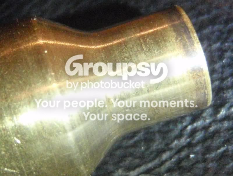

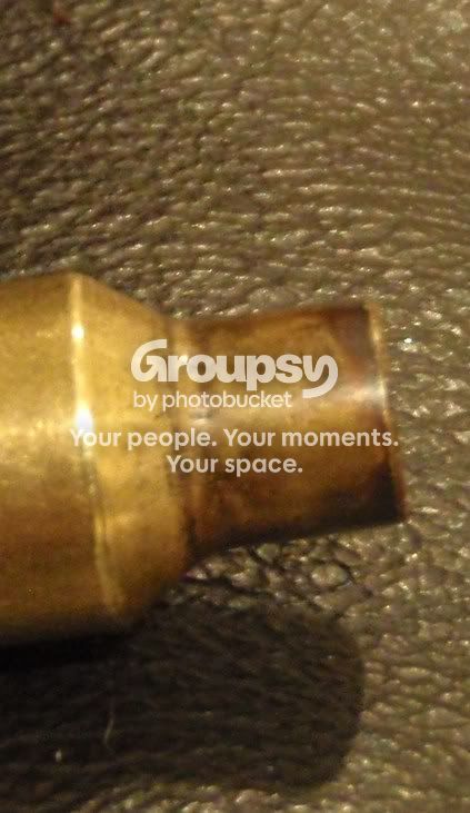

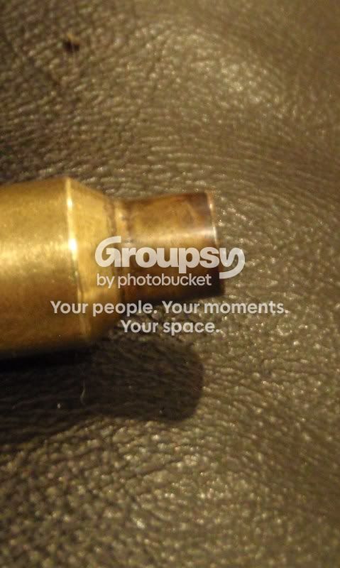

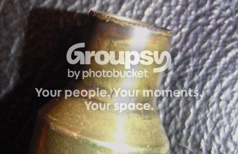

They are cracking horizontally around the case neck and shoulder. I did notice that the brass was very soft and easy to trim. I suspect that it just can't handle being worked and is cracking do to that. (work hardening). It reminds me of toffee. Nice and soft and will bend, but you hit and it cracks.
My old 30-06 brass was 1 fired factory ammo that i loaded more than 10 times and never saw any thing like this.
I realise the metal has been work hardened but am just wondering if this is more normal for this caliber or maybe this is a bad batch of brass. Also with a small pic you can feel the cracks on the inside as well.
There are no pressure signs on any of the brass or primers.
Here are some pic's.
