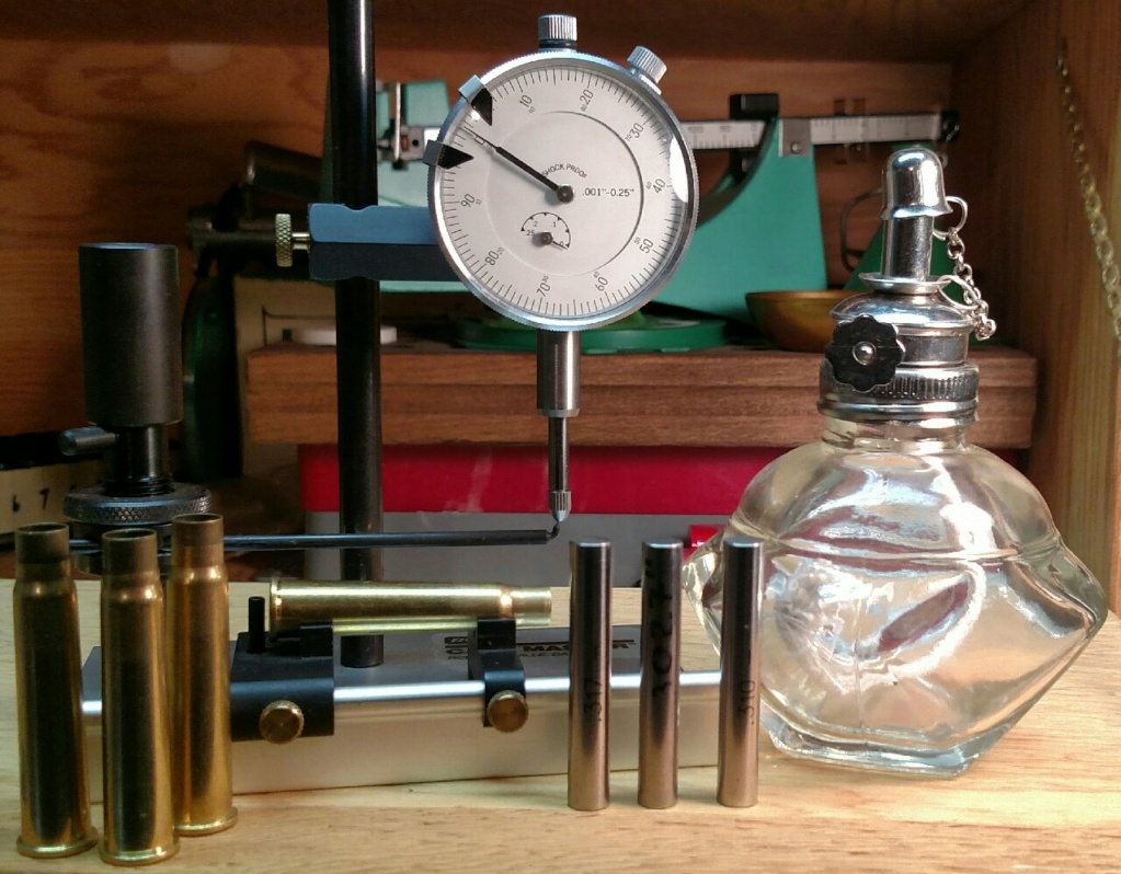

For checking inside the necks, I use the probe/pick from the RCBS dial indicator comparator tool to feel; not taking a look inside. If you ask your dentist nice, they will give you their dental picks or explorers or what they call them that they're about to throw out, those are nice and rigid to check for developing case head separations. Maybe like you do I should look as well (but my senior citizen eyesight sucks), but I haven't had a case head failure when I discard any case that fails the probe scratch test. If I saw those rings in your pics, I'd probably junk those cases. And maybe section them to see what was inside.
The RCBS dial indicator measurement tool may well be over the top for people who have less exacting standards to reach the point of fun with their rifles. But (as a relevant example), it can not only be used to detect the beginnings of case head separation, but give comparative readings for different brass from different manufacturers from the neck all the way to the web, at pretty much the exact same spot on all pieces of brass measured.

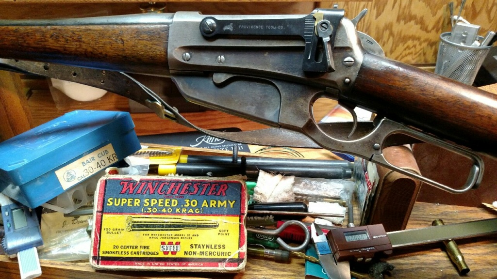

The same techniques for case life/best fit also work for very experienced old rifles, like my Grandpop's old 1895 Winchester. I don't know what the bore measured when it was manufactured back in August of 1898 in 30 U.S. Now it has dimensions where bullets (jacketed or cast) intended for .303 British are far more accurate. Different issues, but same in that you don't want to unnecessarily size down/expand the case any more than necessary.

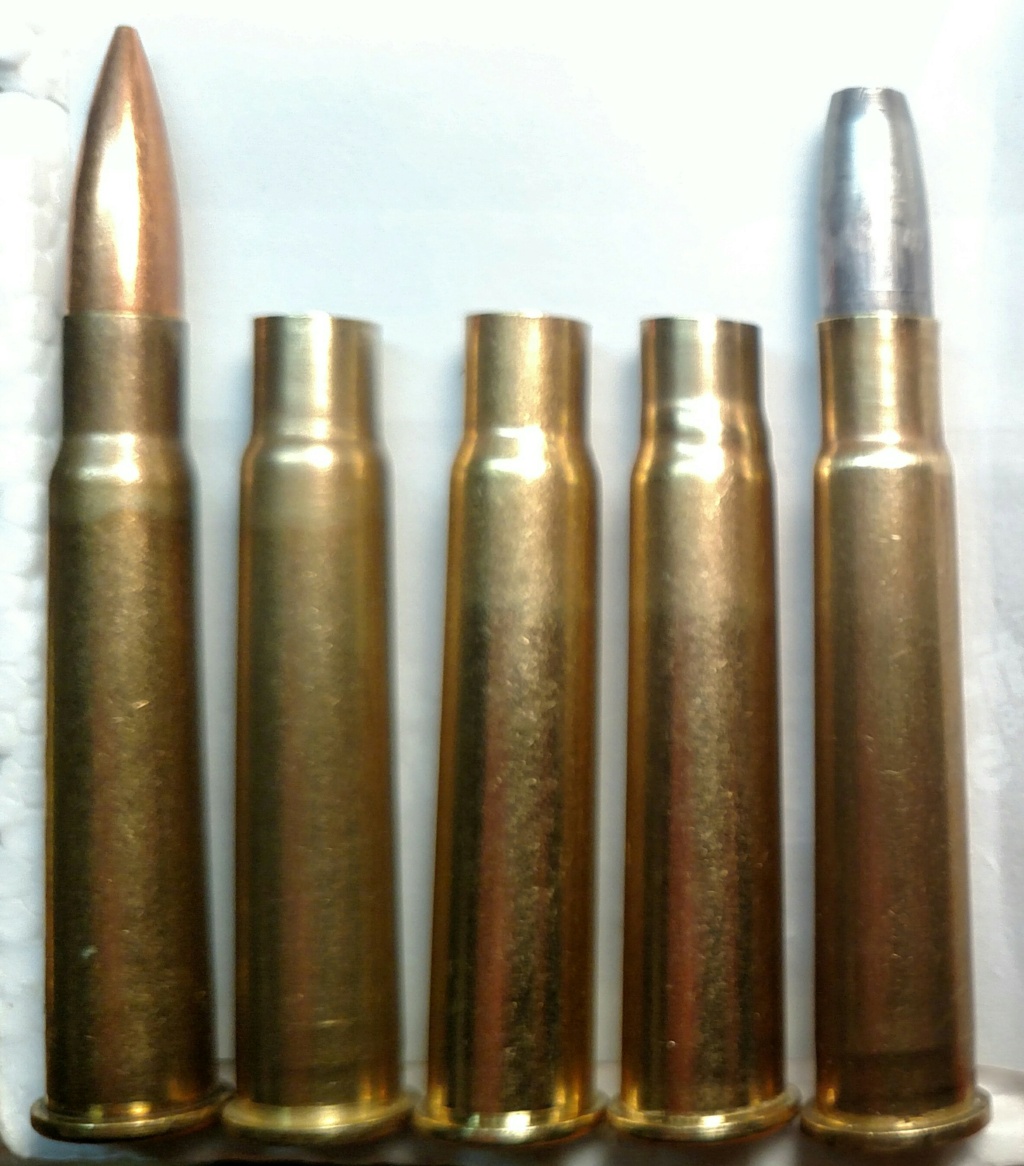

From the left: a Greek HXP 68 ball round, a fired HXP 68 ball round from the same lot, a new out of the bag PPU casing, an unfired PPU case with false shoulder applied, a loaded numerous times HXP case.
Even with a really, really tight chamber, look at the differences in the shoulder position.

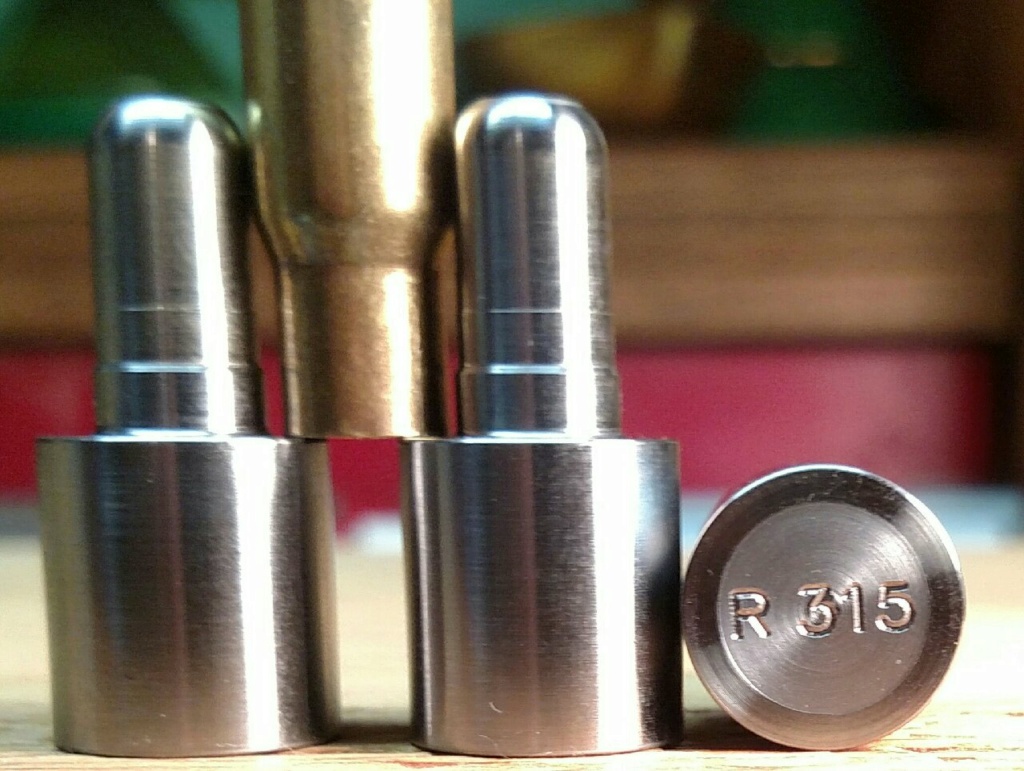

A set of NOE's neck expanders can really help with optimal neck tension, as well as a much bigger one to expand the neck in order to apply a false shoulder.
In my rifle with my dies, I need to expand the neck to at least .33" before the neck sizer will establish enough of a false shoulder so that you can hold the case under tension between the chamber shoulder at the front and the bolt face at the rear. If you also go the cast bullet route for your Lee Enfield, neck expanders to get the right fit to the case neck really make life a lot easier (and sometimes make a huge difference in accuracy). I think they're about $6/each; you just stick them in an inexpensive Lee universal expanding die.
For sorting out case life issues, prolonging case life, etc there's some other useful tools to have on your bench:
The RCBS Casemaster tool or something similar for all kinds of measurements, detecting bullet runout, case irregularities, comparing cases, checking for incipient case head separations, etc...
An alcohol lamp for annealing case necks is dirt cheap. I think I only paid about $11 for this one, mail order, about 20+ years ago. Made in Taiwan I think, but the concept is no different than a kerosene lamp; nothing complex. I use alcohol gas stabilizer to fuel it - used to use white gas backpacking fuel, but this is a little less sooty with alcohol.
And pin gauges in .0005-" increments are a bit of a luxury, but can help with case neck I.D. after sizing, pinning the bore on a rifle (whether because it's a five groove barrel, whether you wonder if the barrel is consistent from end to end, or you need to know bore dimension just in front of the throat because you're contemplating a bore riding nose cast bullet design)
