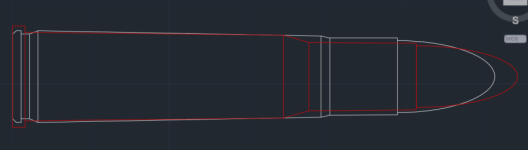

FYI: Here is 303 savage versus 35 rem. There is a spot at the neck where the 303 case is 0.011mm wider that the 35 rem case. But it the barrel is setback .598mm it matches width and works. So maybe spinning the barrel in one more thread etc. will make it a possibility. And thinking about it, I suspect it would be fine to try, resizing should be able to handle 0.011mm with a little case lube
In the above picture the 303 sav is red, the 35 rem is white.
I was up late last night looking at dimensions of hangun ammo. 460 S&W ammo is a possible candidate, maybe even 500, but would have to check the rotary mag. also the 360BHMR is a possibility.
303 case is .011 mm wider in one place than the 35 remington? That is 4 tenths of one thousandth in imperial. Wouldn't that be insignificant?
I had to think about this for a day myself… my conclusion is that it is insignificant and will be handled with reloading dies.
