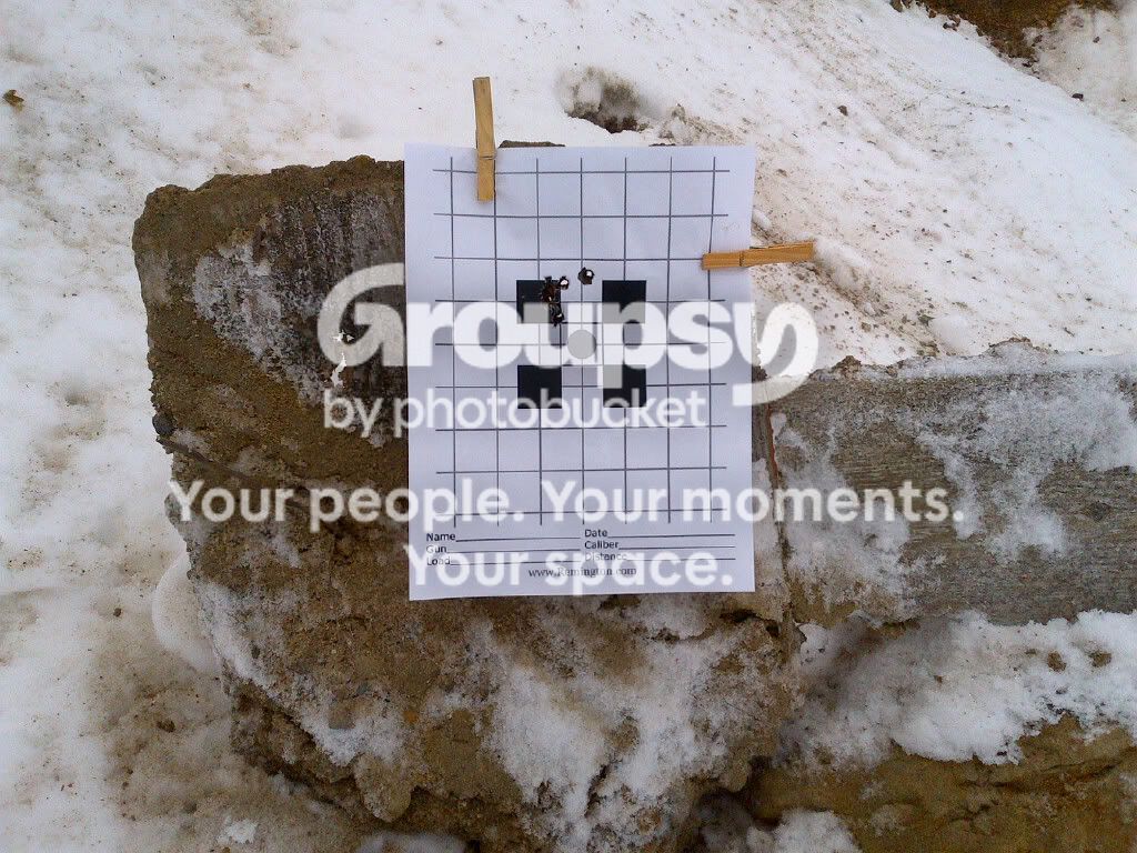

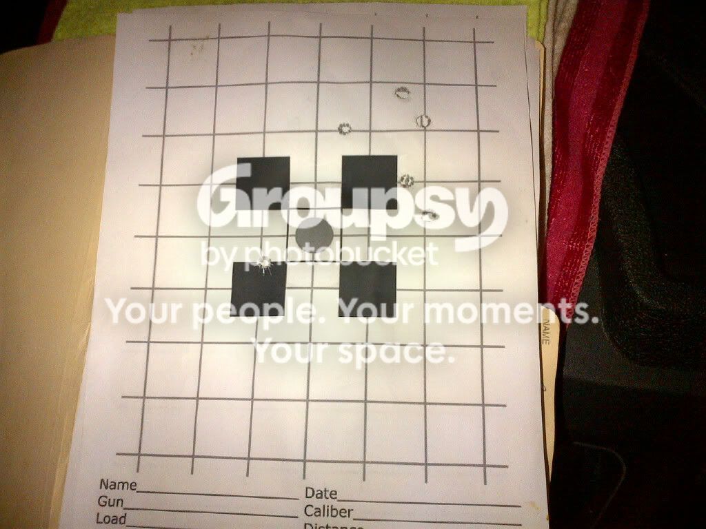

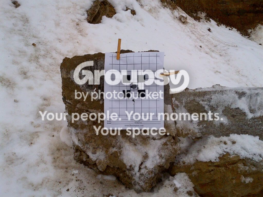

Well I got out today and tried out the new reloads, drove to the local pit with the ATV. I was not impressed by the recoil as I thought it would be less but it is a FCXP3 Savage package firearm which is light. The specs say 6.5 pounds but I have never verified it.
The first shots were at 25 yards to sight it in. I was cold from just driving their on the ATV so I did not do too well. Two three shot groups, one as I arrived and one after adjusting the scope.
The next was at 50 yards and I was impressed with the six shot group (under an inch) with one flyer using the ATV as a rest.
I then had a neighbour hear me shooting and he stopped by. When he left I was cold again and I was not impressed with the 100 yard group so I packed up and left (2½” group of six with one flyer). I will get out again and see if I can keep the firearm from rocking and maybe dress a little warmer to.
