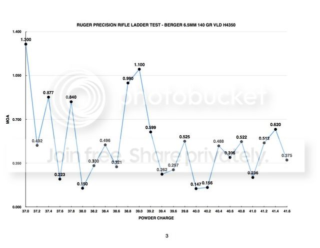

Another shooter (MikeinCalgary), just did my load tuning test with his new Ruger PRS and plotted this data. See my website for links to the articles.
Testing was done with 2rds per powder step at 300m.... pretty darn good shooting for a factory rifle.
This sums up why I feel my process is so powerful without eating up alot of components. Very clearly see where the nodes are and now he can go back to retest in larger size groups to confirm. It will also be to chart where he is starting to see pressure signs relative to the accuracy nodes.
There will be nodes that will not continue to be accurate as they are "unstable" and can be dropped - small changes in powder charge lead to big changes in group size. But there will be nodes that will repeat in larger rd groups and be tolerant of small changes in powder charge... pick the one in the magnum pressure range, with the lowest amount of vertical and enjoy.
"Standard" pressure loading would be in the 39.4 to 39.6gr node
"Magnum" pressure would be in the 40 to 40.2gr node (when near max pressure, small change in powder lead to big changes in operating pressure).
Over pressure - 41gr load... look at how unstable it is with very small changes leading to big group size changes. This is the load that will drive you crazy in varying temps. Odds are pressure signs will also start to occur
Most peak accuracy nodes are only 0.2 to 0.4gr wide for most common cartridges including standard magnum cases.
In this example, I would retest 39.9, 40.0, 40.1, 40.2 and 40.3gr in 2X5rds groups and see what looks the best...least amount of vertical. I wouldn't bother with OAL testing as you aren't going to improve over this level of accuracy at 300m
My guess is this load will settle out around the 2's to low 3's in larger size groups... and again, depending on how stable the barrel is to heat.

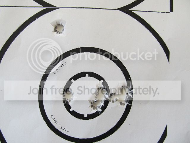

Yesterday I tried a few progressive loads of N550 behind a Hornady 168 gr HPBT Match bullet. The Federal cases were full length sized, trimmed and then primed with Federal lg. rifle primers. Bullets were seated to 2.808". The rifle is a Ruger Precision Rifle with a Vortex HS/LR scope.
Fired at 100 yds. (I know it's short range, but I was just working up the load)
I started at 33.4 gr, then 33.9 gr and finally 44.4gr. the node was at the 44.4 gr. mark.
I fired the first 3 and saw what looked like one big hole. I fired the forth round and proved without a doubt that I suck.

hahahahah - I hear you!!!! just when delusions of grandeur start entering your mind - BOOM - there goes your group!!!! Even with your flyer, you realize thats better than 70% of shooter/rifle combinations can do, right???
Nice shooting!! Those RPR's are sure performing....

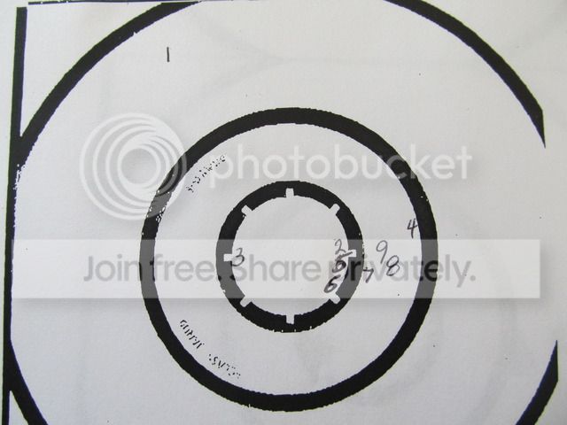

Was out doing final testing on my Shilen barreled FTR rifle at 250yds... was gusty and windy so decided to shoot for score instead of group.
Shot 1 was high as I added some elevation in anticipation of the head winds but it was too much... dialed back down and the next 8 rds were with the same scope zero. Could have added a bit more left windage to center up the group but was mostly worried about vertical which seems to be working just fine
And here the plot for the firing order of each shot.
