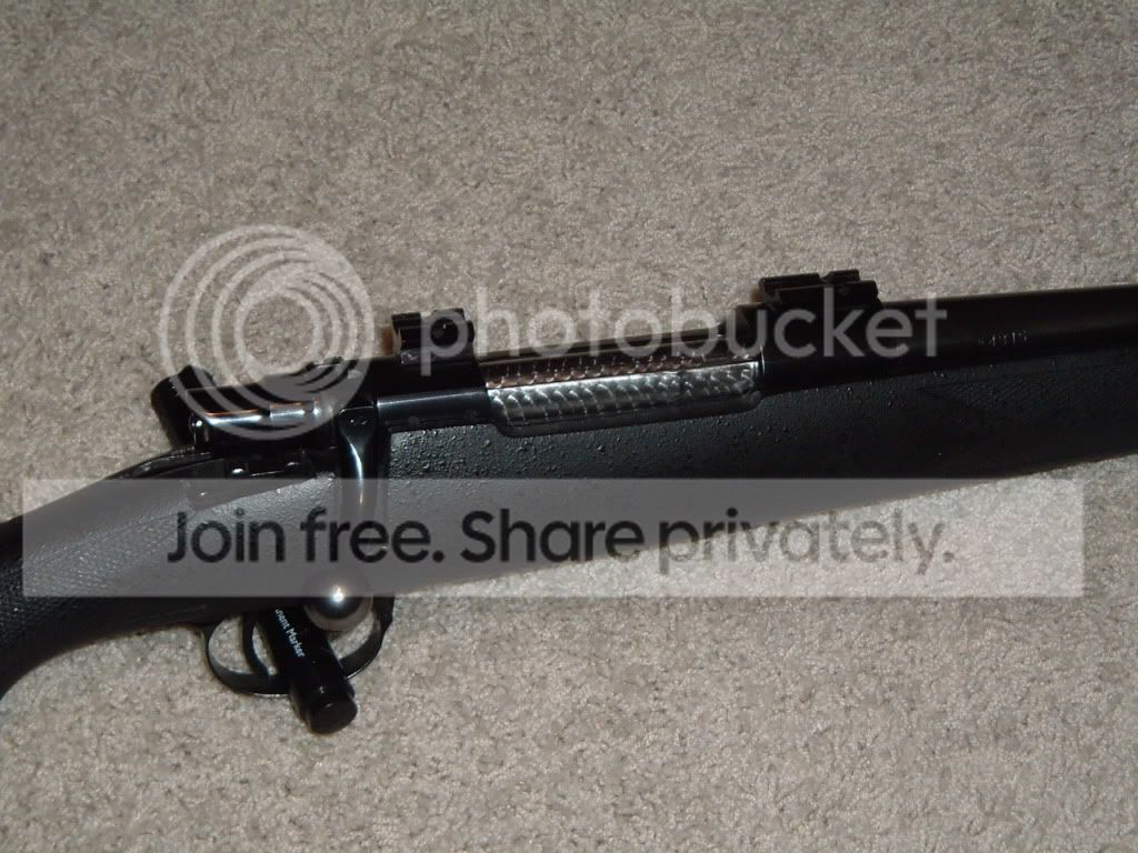

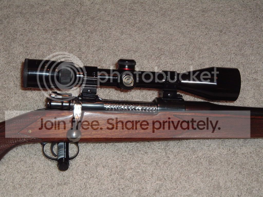

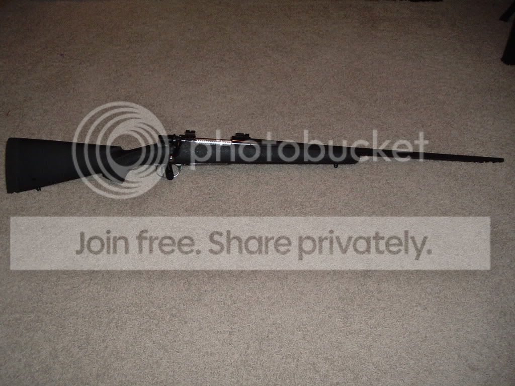

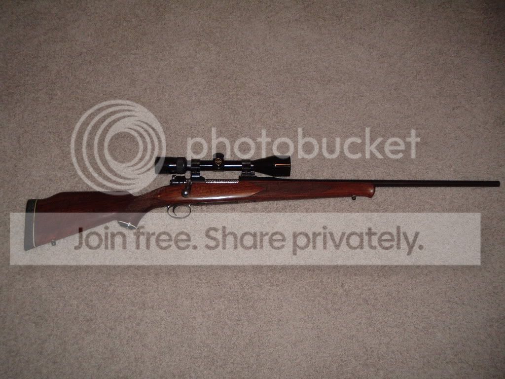

I love the 308 Norma Mag [Don't think that is any secret to those who know me!]
I have 2 at present.
One is a Parker Hale Model 81 "Classic"
The other is a custom rifle built on a 700 Remington action.
These are both very accurate rifles, with the custom gun far exceeding my expectations.
I have shot several groups at 200 meters that are well under 1" with the 180TTSX.
The PH loves the 200 Partition or Accubond and Reloder 25.
This load is a potent package at right on 3000 fps.
I believe this is the cartridge Winchester should have adopted instead of the 300 Winny.
Here are pics...the Remington now has a new scope, a 3.5-10x40 B&C
These groups were 3-shots at 100 meters.
Regards, Eagleye.
