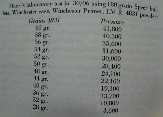

You wanted proof from Hogdon's testing, here it is.
Bruce Hodgdon is talking about people saying light loads blew up their case.
and here.
Note that every single reduction in powder reduced the preessure.

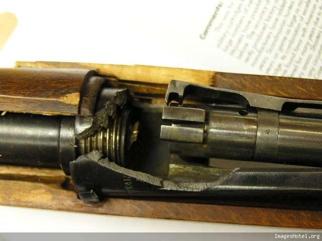

Now I know S.E.E is unlikely in a reduced charge of medium burning powder in a .308 winchester case but it doesnt' mean its a good idea. If one wants to reduce I still think he should do so by the guidelines laid out by manufacturers.
At least a couple shooters on cgn have blown up M-96 / 94's with reduced charges I believe one is Baribal and I forget the other(s)
While P.O. Ackley half-failed describing and documenting the SEE, Norma of Sweden were able to reproduce it at will with a combination of the M/94/96/38, the 6.5X55 using less than 80 to 85% of load density of slow buring powder with their MRP powder and others from various manufacturers.
They show a picture of this on p.141 of their No. 1 reloading manual. they also describe the process on p. 149.
The phenomenon can be explained that way; it's a conjunction of low density load of slow burning powder in a large volume cartridge (large for caliber) especially when using heavy / long bullets (wich increase friction) in a long throated chamber / barrel. The powder load leaves an empty "chamber" over the powder and the primer ignites the coated powder mostly on top of the (coated) powder load, wich creates enough pressure to push the bullet further in the land (barrel engagement) and because the combustion heat was not enough to light the whole powder charge, there is condensation of the primal vapours wich re-ingites (acting like an accelerant) the whole powder charge. Then, because the bullet is now located far from the initial place it should be, the empty room (in the case + the barrel) to reach the bullet butt acts like an even bigger chamber, the bullet is now like a barrel obstruction and the pressure is peaking high very fast.
From my discussion with one of their lab tech, it seems Norma can make it happen (at will) with almost any magnum caliber with slow powder, and it's even easier if the caliber is less than .30 and the throat is quite long.
The pressure surge goes over 80 000 PSI in afraction of seconds.
One of the sign a SEE happened usually is the absence of visible barrel obstruction and damage - leaving the barrel "untouched", or undamaged. The action blows but the bullet almost always goes out of the barrel.
It seems that one way to avoid this is by using a case filler, such a those used for low-density loads for fast-burning powders reduced loads for handguns. all in all, a slow burning should never be loaded to less than 80-85% of the case capacity.
I think I am a reliable witness, because it happened to me with a starting load. and I am an experienced reloader and shooter who always double-check his expermental loads...
There were a couple of very interesting articles published in the past about Norma's experiments; one the most interesting one is "The Secondary Explosion Effect - Can the mystery besolved?" by Mauritz Coetzee & Shaun Kennard.
