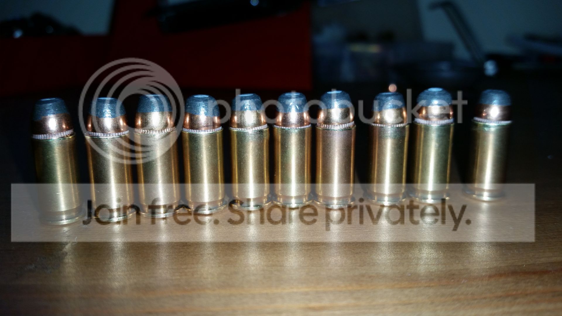

Hey guys,
I am having some issues reloading .32acp. I just started reloading with 9mm and had no problems with that. The .32 seems to be a different story.
My setup consists of a lee classic iron 4 hole turret press with a lee .32acp 3 die carbide set.

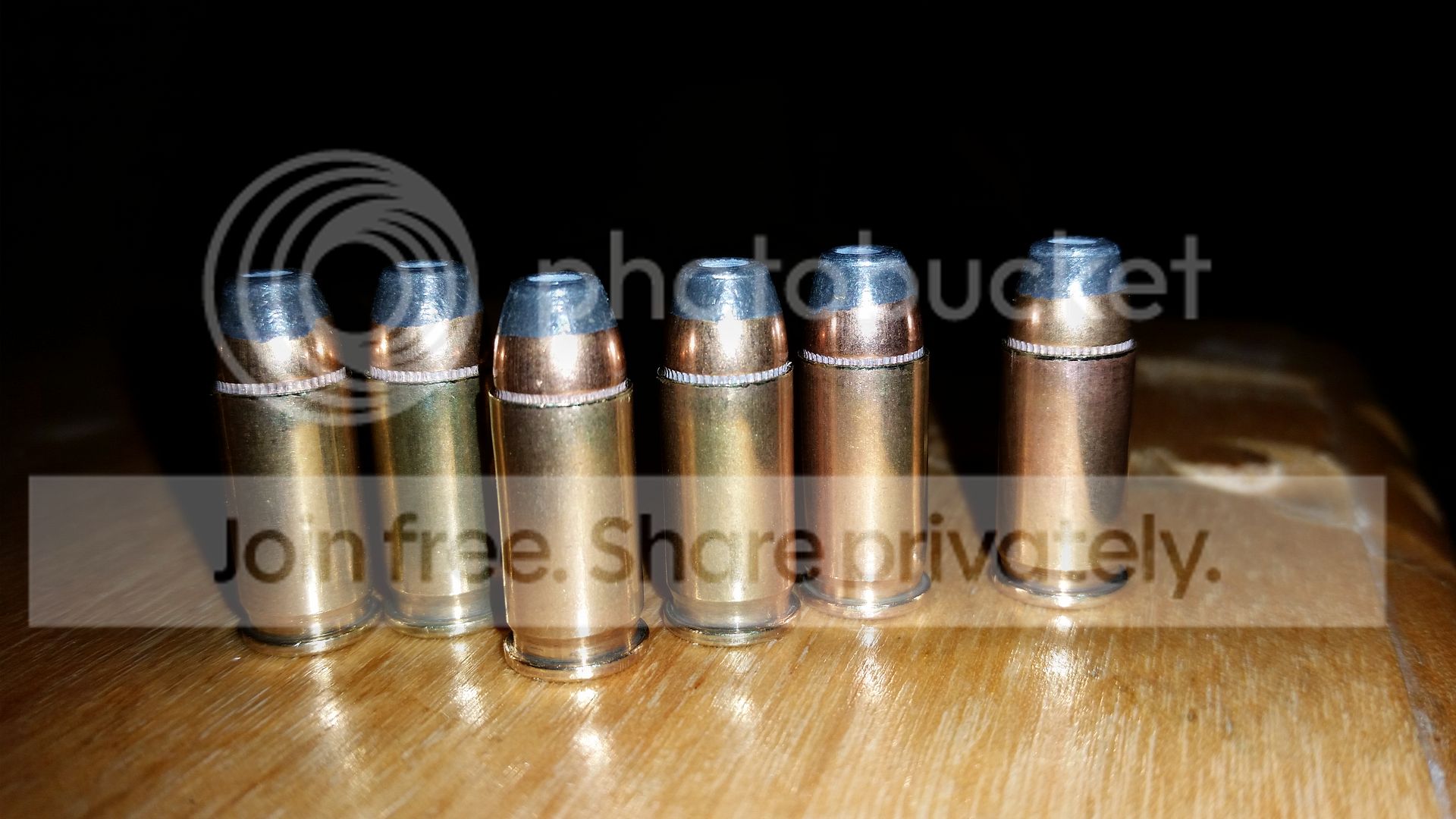

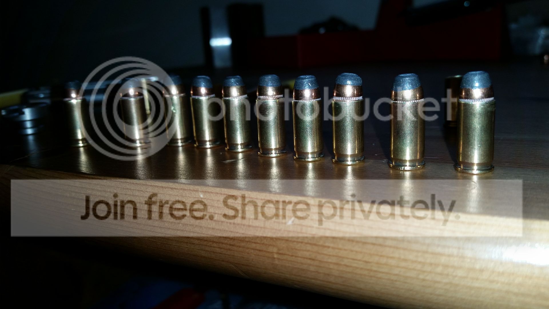

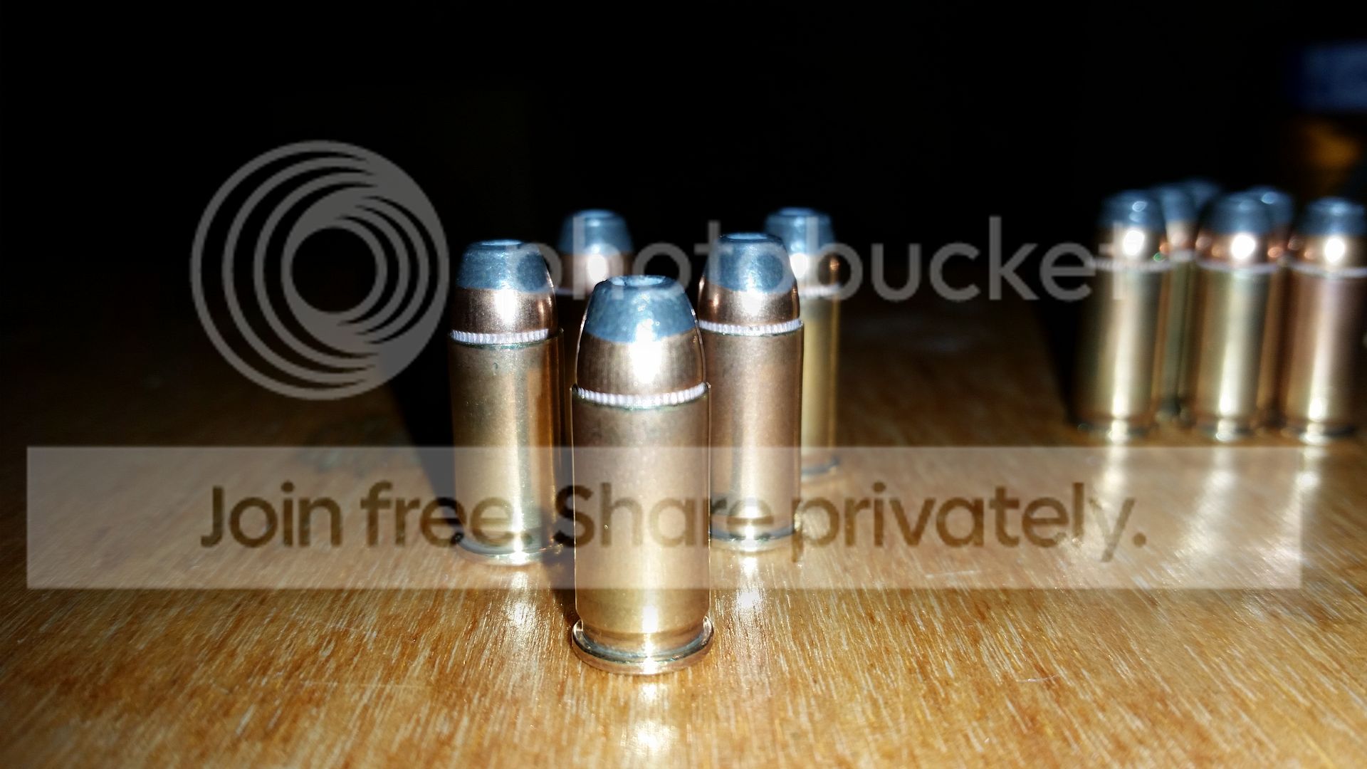

Now here is the issue(pictured). I cannot get the bullets to seat straight to save my life. Maybe one or two out of 30 seat straight lol. I dont want to waste anymore.
So i realize there are two different specs between european .32acp and north american .32acp. The euro is a .308-.309 bullet diameter. The north american is .311-.312 bullet diameter.
I am using euro spec 60gr hollowpoint and euro spec brass. The lee bullet seating crimp die says .311 on it. Is this the problem? The bullet doesnt seat straight due to the loose tolerance?
Any help would be great.

It does seem to lean to the same side every time. Dont know if i can get a flat plug for the lee dies. Could something be wrong with the die? Can i modify the seat plug flatter?

The nose shape of the bullets in your photo are pretty flat for .32 ACP. Perhaps try to pick up some FMJ round nose bullets to see if they sent differently...that may be a cheap way to diagnose whether the seating plug shape is part of the problem...
Ok so i ended up modifying the seat plug and it appears to have corrected the issue. I actually used a drill press to make the plug a bit deeper actually to better accept the bullet. I think it worked check it out. Oh and as far as the bullets i am using, i would prefer fmj but i cannot find any in country.
