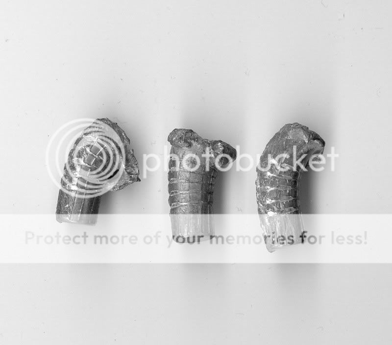

Cast bullets recovered from dry sand - low impact velocity - high target density

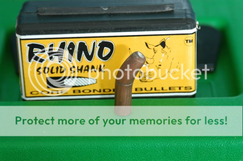

.375/380 gr Rhino recovered from an old dry 16"X16" timber - high impact velocity low target density
A trio of .375/380 gr bullets recovered from a snow drift - high impact velocity low target density

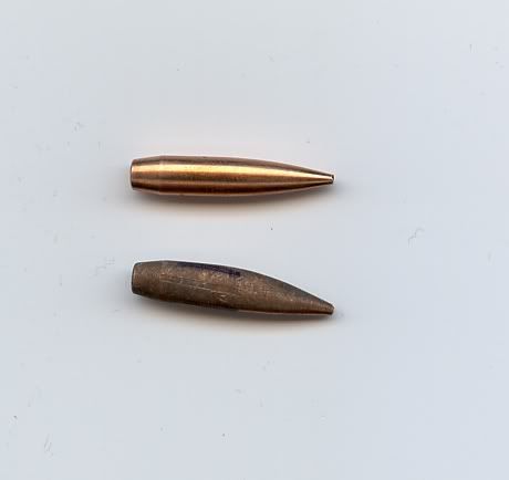

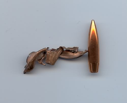

Match bullets though produce unpredictable results at impact: sometimes they grenade, other times they slip through like a needle through cotton, and the target material and/or density doesn't seem to matter . . .
The .338/250 Scenar is a long for caliber bullet whereas the Sierra .308/155 Palma bullet is short for caliber. When a bullet passes through a dry medium, it is less likely to perform as designed, particularly a long bullet who center of gravity is near the base. In a dry medium, a long bullet will have a tendency to bend and hook through the material, whereas in fluid medium, the bullet expands as designed, moving it's center of gravity to the nose, resulting in straight line penetration.
BINGO...Now that the snow is retreating I have been picking up bullets down range...The .308's are blunted but straight...The .338's are like you say hooked...Where have you been to know this fact, very impressive...I scratched my head when I found these bullets last week but no light came on.
