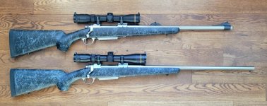

Bottom rifle...

I don't feel the call to the Whelen is relevant anymore. Don't get me wrong, I am a Whelen fan, and have owned and hunted with several over the years, including a beautiful Ruger No.1... i like pretty much all .358 catridges... but these days, there is no issue with finding .300 WSM brass, many have it already on their bench, as I did, several hundred in fact... so as far as "easy" goes, it is just as easy to build and Feed a Sambar as it is a Whelen, and let's be honest, a Sambar is much cooler! The question of action length can be easily answered... go long. I built my .375 WSM on a Ruger Mark II Stainless action that started life as a 7 Rm Mag, twirled on a 24" Bob Jury #3 barrel and added an Alskan Arms Coffin mag plate to bring the mag capacity back to four rounds. As I said earlier, it is a corker cartridge and the case is ideal for the lighter .375 bullets, up to 300 grain. I liked my Sambar alot, and shot many bears with it and a couple moose, but I LOVE this .375 WSM it is hyper accurate and pleasant to shoot... to be honest the .358-375 Ruger was a smidge too much of a good thing for where and how I hunt... If I were left of center it would have stayed right here... but the .375 WSM isn't going anywhere for the foreseeable future... I took a medium bear and moose with it, and will test it out on PG in a couple months. I also put together a new .458 WM Stainless Carbine, to complement my RSM in .458 Lott, and shot a doe with it this fall, just for S&G... the .458 WM will mostly be carried while guiding and hunting bears in the Boreal... I prefer big chunks of lead at slower speeds to the light and zippy group at least for bears, less messy and just as effective.

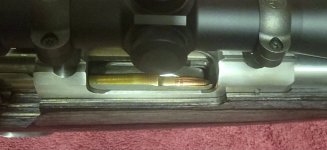

There is no reason that you "have" to go with a long action, as you can see here in the .375 WSM, the 300 grain Sierra #3000 is in the neck @ 3.050" and the 235 TSX flat base also @ 2.980".
Here is the TSX load in a .350 Rem Mag short action (I sold the Sambar to a friend), same action length and Mag box as the WSM chambered rifles...
The bullet nose just barely catches the front of the mag box, so, shorten a few thou and you are still in the neck but functioning in a short action just fine. However, I was not willing to accept any of those possible limitations, and so built on a long action. The TSX likes a longer jump than the Sierra, but I have used the #3000 many, many times on lots of game with excellent,.might aswell say perfect results. The #3000 was of sturdier than normal construction, designed specifically for the .375 H&H.
If all you had available for a donor rifle was a short action magnum (WSM), I would have zero qualms about using it for a Sambar or .375... if you have the option available, I would choose a long action for the build.
