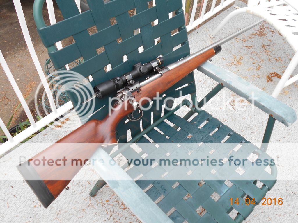

This one has been in our family since 1964.
Dad brought it home from a gun show table in Montana.
It had a 26.5" barrel, iron sights as well as a scope and was a pretty hefty piece of ordinance for a skinny teenager ( me ) to hunt with.
Thus began my reloading addiction.
Over the years only one thing has bugged me and that is what should I do to fix the hole in the stock that was cut out for the old receiver sight.
Bevan King replaced the tired old John Buhmiller barrel about 20 years ago..... I will measure twist in it..
Bevan's 35cal bbls were 1:14" twist and shot very well.
Bevan's barrel seems to shoot any bullet weight well and much better than the original barrel.
My favourite bullet was the old long discontinued 275 gr. Hornady, would love to find some of those.
They were nothing spectacular, just a good dependable hunting bullet, reliable expansion and opened up well.
