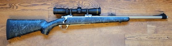

I like all .45 cal cartridges pretty much. Since I download the Win Mag for bears, the .450 Marlin made perfect sense... and worked well for several bears over the couple years that I used it. I shot dozens of bears and deer for over 30 years with various .45-70's... then started using my DG rifles more often, just to stretch their legs a bit... .416 Rigby, .458 Win Mag, .458 Lott, .450/400, .450 Nitro... for the most part, these do not require full power loads for most NA game, so I mess around with different bullets and loads... most are successful, but a couple have been spectacular failures.
Ruger M77 Mark II Carbine .458 WM, Barnes Original 400 grain SP;
