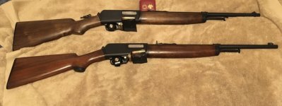

357 maximum
there are actually 2 we made ,one went to my uncle and disappeared last year after he passed away and the one I have .
most of the time was figuring how much weight to trim off the counter weight to get it to cycle reliably
mag follower had to be ramped to feed rimmed cases
mine has a 1907 barrel and it slugged at .354 so I just use the bullets for the 350 legend (.355) 175 gr
it was a bit of work to make the first one and mine was easier as all the hard stuff was done,
groups in at 2 inches at 75 yards but its not a target rifle
It will also cycle the HSM 357 mag bear loads reliably too with the 358 lead 180 gr ,group opens up to just around 2 1/2 +- ,again I think it is ok too
