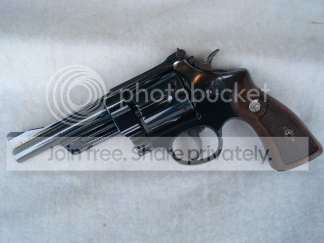

Here's one of mine . . 1952-53 pre Model 27
Here's a couple more . . another pre M27 and a M27 no dash
Here, for comparison, is a Highway Patrolman, M28 no dash (1957-58)
