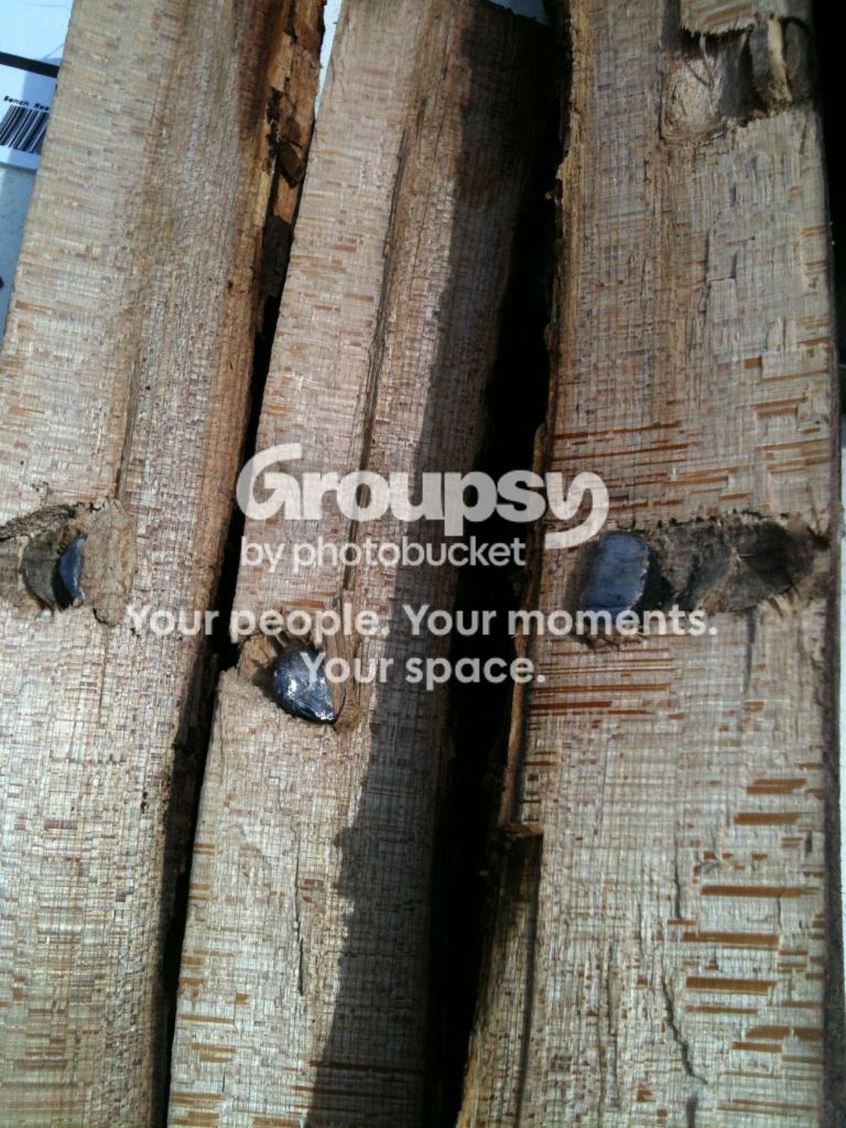

Just incase any one was wondering how much power .36 cal black has. This is 15.5 gr of goex fff in my pietta with a 7 in barrel. Deepest is 1&1/4 at 15 yds into maple.

Good test! That's lots enough power. How far were you from the target?

IIRC about 7 yards or so for myself. I've also tried 38 rimfire loaded with 9mm flobert ball ammunition, improvised with a tiny bit of smokeless pistol powder in the small case. At about 3 feet I had maybe 1/2 inch penetration. (3 3/4" barrel) Yeah, not inspiring.
At the same distance the .36 cal balls just pancake and drop to the ground when shot at 1/4 inch steel plate. Doesn't even dent the plate. Just leaves a small round mark. I will try some lite ga. Sheet today and some pine for comparison.
Thanks Gasoline Boy for your post. I never thought to ask about your RB bullets and steel of any kind because I can think back to many youthful experiments as a teenager using a 12 gauge with foster slugs on similar targets. Predicatable results IMO.
