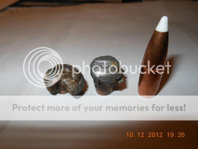

Northman999, these two 260 ABs were recovered from 2 different elk. Both were recovered up against bone on the offside. One from 220 yds. the other from 340 yds. Fired from a 375R at a fairly sedate 2600ish fps. so a far cry from a RUM at point blank. The only other one I can comment on was through ribs and boiler room at 300+ and not recovered. I have some TSXs to mix up and try but have no negative comments re: the AB retention or accuracy out of a M77 Hawkeye.
