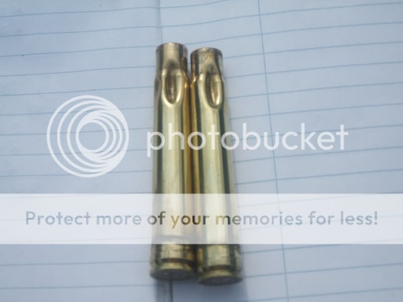

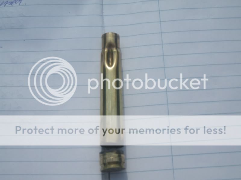

I was shooting some test loads in my .375 H&H Ruger No.1 rifle today and I had one case that cracked right around about 3/16" in front of the belt and the case creased on the shoulder of the case about 5/8" long lengthwise on the case by about 3/16" wide x 1/8" deep. I had never seen this happen before. The primers looked okay so I don't think the pressure was too high. I had it happen with a second case where the case actually broke into two pieces and I had to run a boresnake through from the muzzle to try and get it out. The second case also creased on the shoulder, the same as the first one.
I have never seen this before in all my years of reloading and shooting. Does anyone have any idea what's going on? I didn't shoot anymore after that happened. I was shooting 78 grains of IMR4350 when the first one cracked and 80 grains of IMR4350 when the second one broke. I was looking at Steve's Reloading pages for 300 grain bullets and he recommended going as high as 81 grains.
