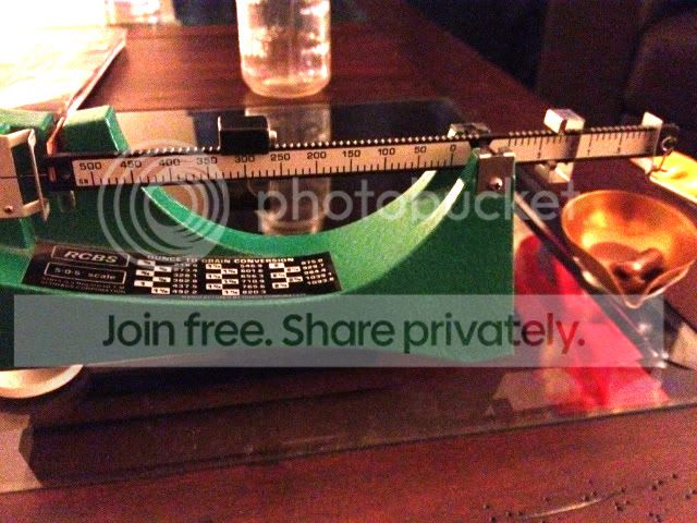

They retain weight like nothing else, as well. The top TSX in the scale went into a Cape Buffalo bull, departing weight 300 grains, finished weight 300 grains. The second TSX sheared two petals, and still acted perfectly, with 297.3 grains retained weight when weighed together. They are an expanding solid, and that's why PH's like them.
