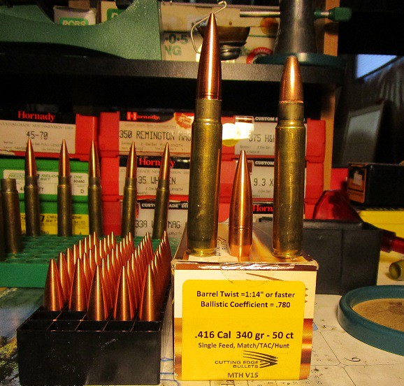

378 WBY ammo isn't listed in ANSI/SAAMI Z299.4. 416 WBY ammo is listed and shouldn't produce on average more than 53,500 CUP.
The Mark V rifle has been advertised as having the strongest action available so maybe WBY factory ammo is held to a lower maximum pressure in deference to WBY cartridge rifles built on other types of actions.
Mythical PO Ackley bolt thrust and brass good to 200,000 CUP?
