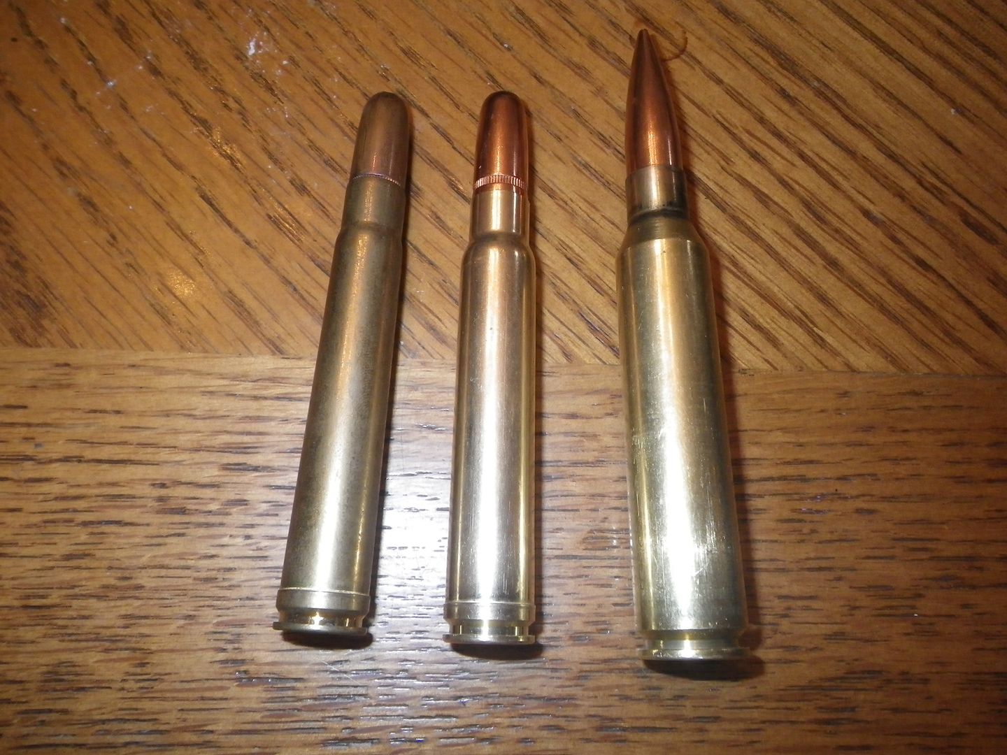

It's a very long taper on that projectile, and it's also a monometal. It's not about the bullet weight so much as it is about the length... It won't fit in the clip of the other 375 type of rifles...
Right, it is the length of the bullet, not the weight that determines the twist need to stabilize it.
Okay, so you are saying the ogive is too long to seat the bullets to fit the magazine. The factory magazine in my BRNO ZKK602 holds five rounds, and allows bullets to be seated out to 3.85" overall length with room to spare.

There is that little matter of the Chey-Tac taking the heavy bullets something on the order of 1000 fps faster. Well maybe not quite, but rounding up seems to be in order.
Here's my little trifecta of .375 cartridges. From left to right; factory Federal 300 grain .375 H&H, .375 Weatherby formed from .300 Weatherby (that's why its a bit short) and the .375 Chey-Tac necked down from .408 with a 350 grain SMK.
There's no particular reason why a sporter couldn't be made around the Chey-Tac. The parent case is the .505 Gibbs, beefed up a bit. The CZ action comes in .505, so a bullet swap to get the length down would take care of that. Recoil would be somewhere around 70 foot-pounds in a 12 pound rifle. Certainly do-able.
