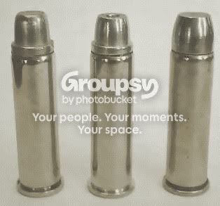

This is an example of a pretty heavy crimp, and is about what my full power loads would look like.
I realize it's a different cartridge, but if it's any help, I reload for .38 S&W and I only remove the case mouth flare. (taper crimp)
Sounds like you have enough crimp to me.
+1 My 357s and 38 spls look like this. This much crimp will work great for lead bullets and jacketed bullets with cannelure.
My only caveat is this: Plated bullets may have "jacket separation" issues if this much crimp is applied. IMO, this much crimp will have the case mouth cut the plating.
For plated bullets that have no cannelure, I use only enough roll crimp such that you can see a slight tuck-in of the case mouth, compared to a perfectly straight case wall.
