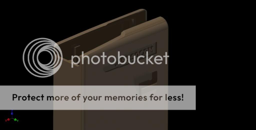

Its very cool for making prototypes and for certain parts, for example I made magazine baseplates for my handgun that are extended so I can use a flared mag well. The down side is YES, the material isn't extremely strong, and under certain types of load the feed lips would definitely crack, or something would break on it.
I also made an MP5-SD handguard for my USC-UMP conversion (although I don't use it often) which has a very skeletonized interior to reduce cost mainly, it's still about 1/8th inch thick at most places which is the minimum I would go for anything structural. It still has 2/3rds of the handguard supported by the factory USC receiver.
So while it's a very cool way to make stuff, and some structural parts are feasible to make - Something like a magazine is not, unless you had the space to make thick feed lips. If you wanted to make a single or 1.5x stack magazine then it would possibly work, but it will wear out quite quickly. The fibreglass re-enforced nylon 6-6 or Nylon-6 they use for most gun/magazine parts is an extremely strong plastic for it's weight and volume.
