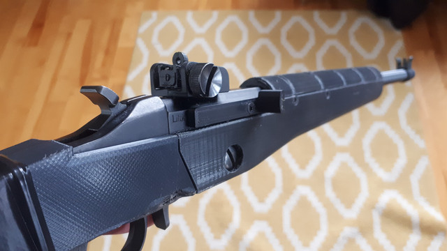

Hi Daver, full printed chassis is serious work! Have you done it for centerfire rifles? I am curious what filament is good for that kind of impact / shock
I have been playing with the 12ga a bit.
No guarantees on longevity but seems to be holding OK.
I am careful about heat though.
I usually stick to rim fire.. the little badgers have a lot of field time.
I’m working on a FTR chassis but using metal parts so the printed portion will just be the adaptor that joins all the pieces together. I think PETG to start and maybe carbon fibre PETG if neededr were
