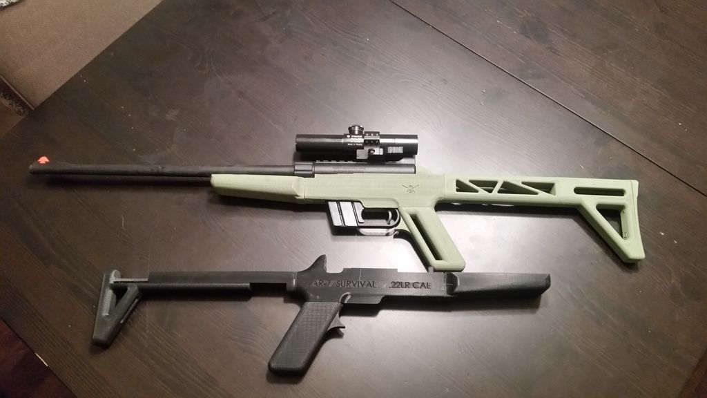

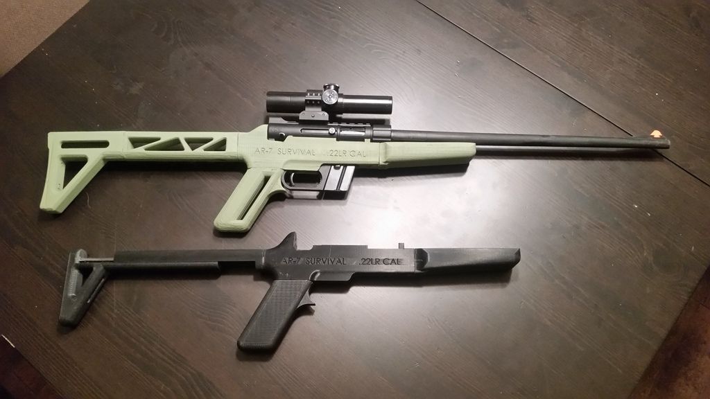

New grip is well underway, I have designed my stock version 2.0
The collapsable stock was not really rigid enough and I didn't need the collapsable feature, instead I decided to skeletonize it and add spare mag storage.

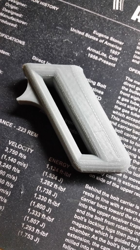

Grip is done, front side looks great, but the bottom of the print is not perfect.
I will adjust settings and try again another day. This one will do fine until I work out the kinks.

Well Update, Version 2 is well underway.
I will do a few finishing touches to it, (I am going to try plastic-dip spray paint for a rubberized coating)

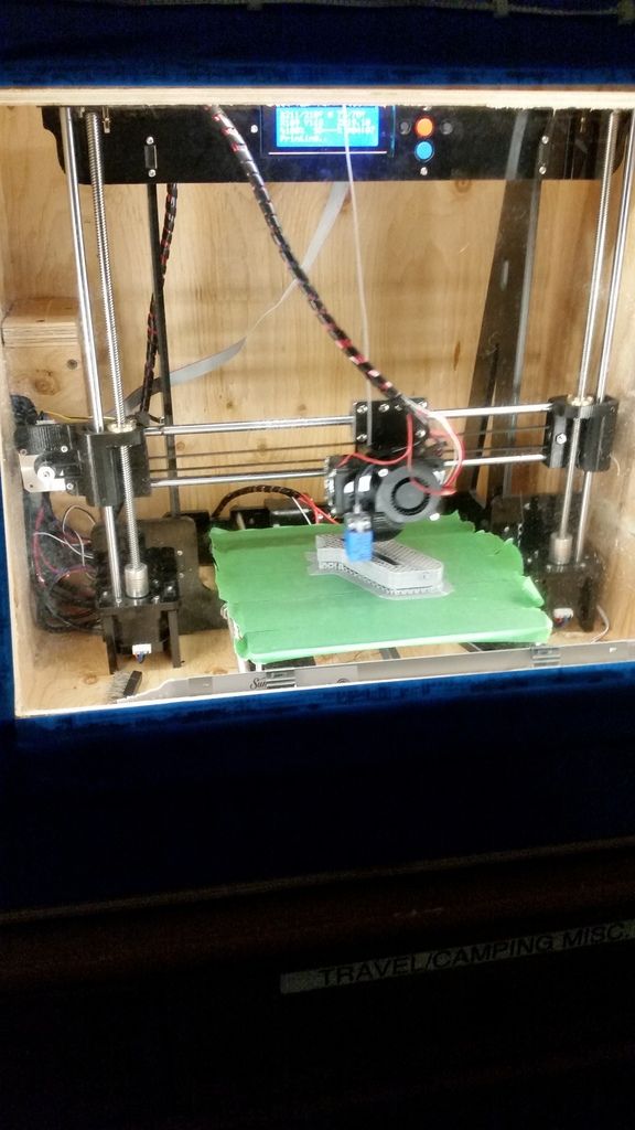

I printed faster this time, and on a much cheaper printer at home, so the quality is lower, but it is just a prototype.
Here are the pics:
And a video of operation.

My printer does 220mm X 220mm X 220mm
So I print in sections.
But i am in the process of building a printer that can do 26"x10"x4"

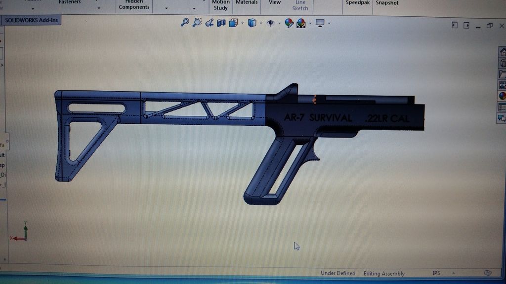

Daver, Very impressive! Not just the technology, but I like your design work. I noticed you are using SolidWorks; I'm no expert, but I have been using SW for about 4 years (mainly for work). I have a question; can you upload the 3-d model directly from SW to the printer, or does it have to be converted to a different format? Does the version of SW cause any comparability issues with the printer software? I run 2013 at work, and I'm still running an old student version of 2014 at home... you have me thinking about some custom grips for my M-57.
When you are done your model. Save it in solid works as an .STL file. Then import it into your 3d printer software (I use Cura)
You can then tweak your settings for infill and thickness. And press print.
