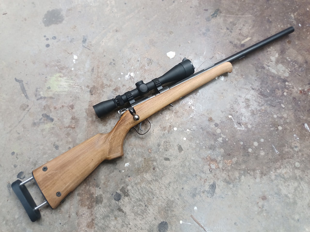

This buttstock, the white spacer, cheek riser, mag base, and muzzle are all 3D printed in PLA. I do not find PETG to be strong enough between the layers! I hope someone can prove me wrong about that.
