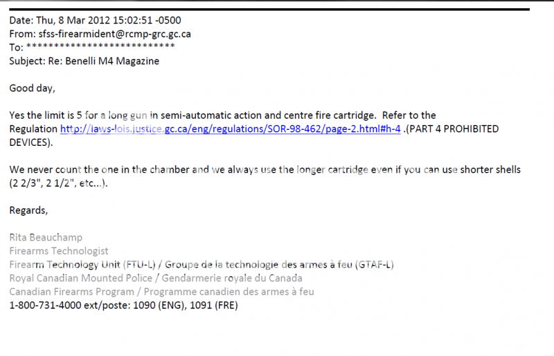

Before you crucify me lol, it was my understanding that 5 is the max limit, until. I spoke with one of the dealers where he mentioned that 4 is max. I gave him the benefit of doubt considering his exposure to the industry, its interesting to know where he base his opinion.

Working at a gun store doesn't make someone an expert on the Firearms Act. I've heard more ridiculous BS in-store than I have on the net.
Magazines designed for centerfire rifles or shotguns are limited to 5 rounds. Not 4.

Being a dealer / working in the firearm industry does not always make you right. This is an example of it. He is wrong. It's 5 of the largest size the chamber is designed for.
