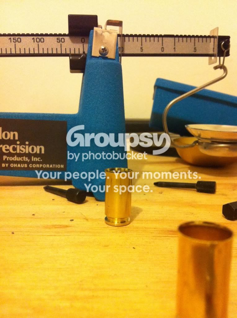

Guys I am just unsure, I have been searching online for a picture or anything clear that I could see and couldnt find anything, My question is that is this too much flare on the shell? check the pic, also, is going 6 grain on my first loads too much?
Im using the Dillon XL650...this is my first go....been at this flare thing for an hour!!!
Way too much flare. You need just enough so the bullet will sit in the case. 6 grains of what powder. Do you have a reloading manual?
The powder is winchester 231. Okay I'll get the flare down thanks
If you put the flared case on the bench like in your photo, and you can easily set the bullet onto the top of it and the bullet easily sits even where you want in the flare (i.e. it doesn't tip and it doesn't take you 3 or 4 tries to balance the bullet on the flare), you've got it right. The less flare, the better. You're shooting to have just enough flare that when you start to push the bullet down into the case, it slides in nicely and doesn't crush the case.
I use plated or jacketed bullets and the bullet will stretch the brass out a little as it gets pushed down into the case.
Also, I use Win 231 for my IPSC major loads and I only use 5.3 grains pushing 180 gr plated or jacked bullets. If you're new to loading, use a good load manual and work your way up in powder. I used steps of .1 or .2 grains and loaded about 10 rounds of each starting at whatever the book gave for a recommended starting load. I marked the side of each loaded round with a red sharpie with the amount of powder. Then when you pick up all that fired brass, it is easier to tell if any particular loads are giving you grief with possible overpressure indicators.

The metal plate on dillon scale holding in beam pivot V-groove is twisted. Make sure V-groove is in proper place. Five thou of flare should be enough.
