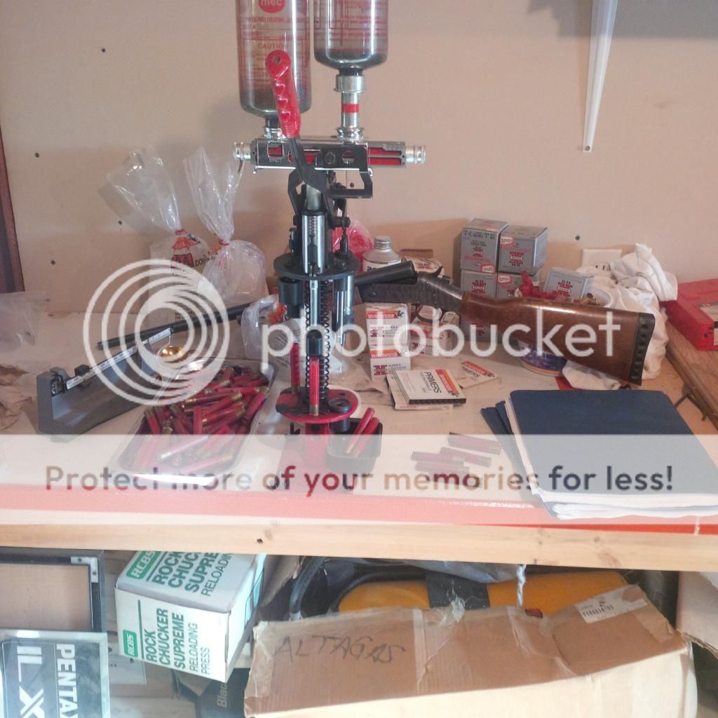

I've only used a Lee Loadall in 12ga and have reloaded about 1500 shells on it over about 4 years (mostly buckshot and slugs). It performs well enough and considering the price difference ($60 vs $300 new) I would buy a Lee again over a MEC considering I don't reload shotshells all that much. I get about 1 in 100 with a wrinkled or messed up crimp which is only about twice the rate I get with my MEC in 410. I got the MEC for only $100 with a couple hundred hulls and 500+ wads so it was a great deal and I'm glad I did it. I wasn't going to buy a press for 410 at all because at $300 and shooting less than a case a year of 410 it would take a few years to break even.

I probably would have never bought another shotshell reloader but like you, I was offered what I thought was a good enough deal to give it another try, a Mec Hyd. 9000 with a lot of components for $300...very happy that I did.
