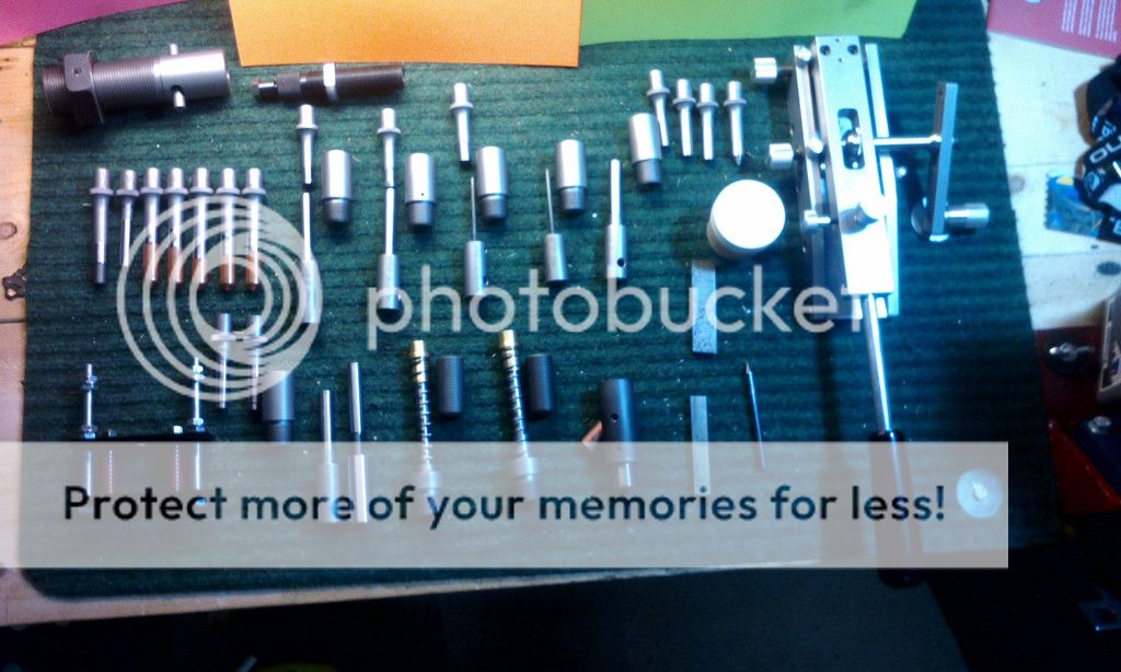

once you have the measurements for each step in the process in order to be able to duplicate that design die setup is critical.
ok... enough blabering...
here is the low down...

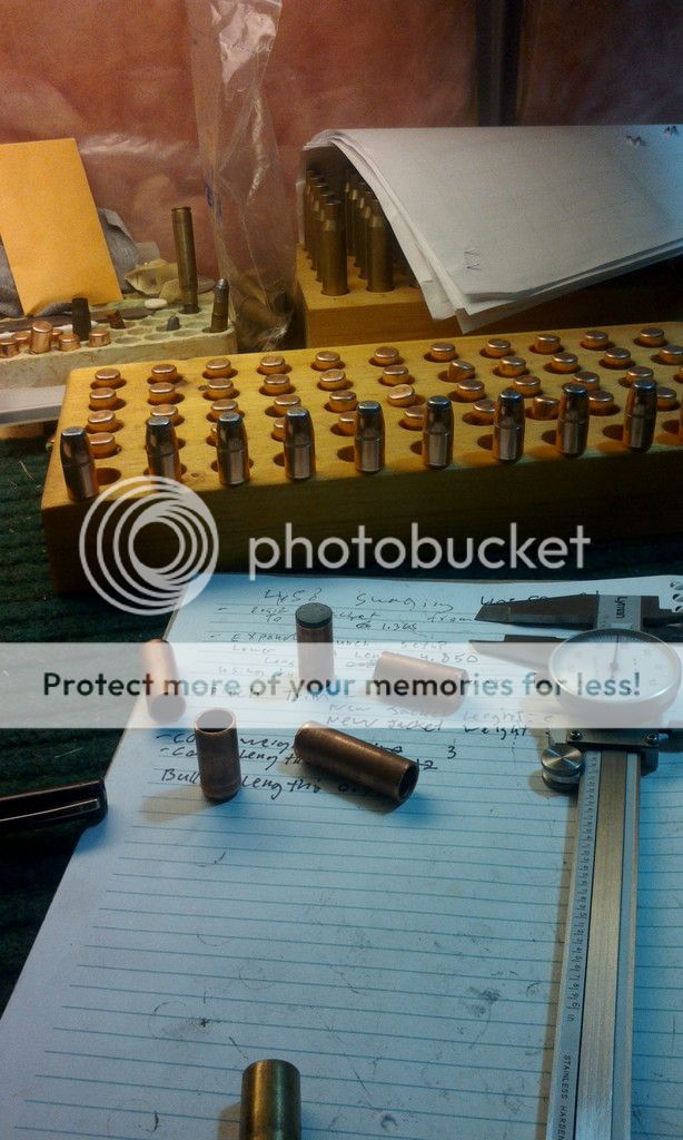

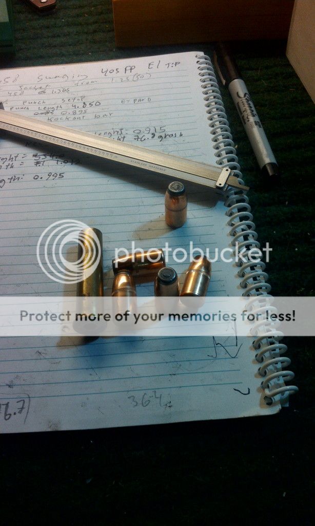

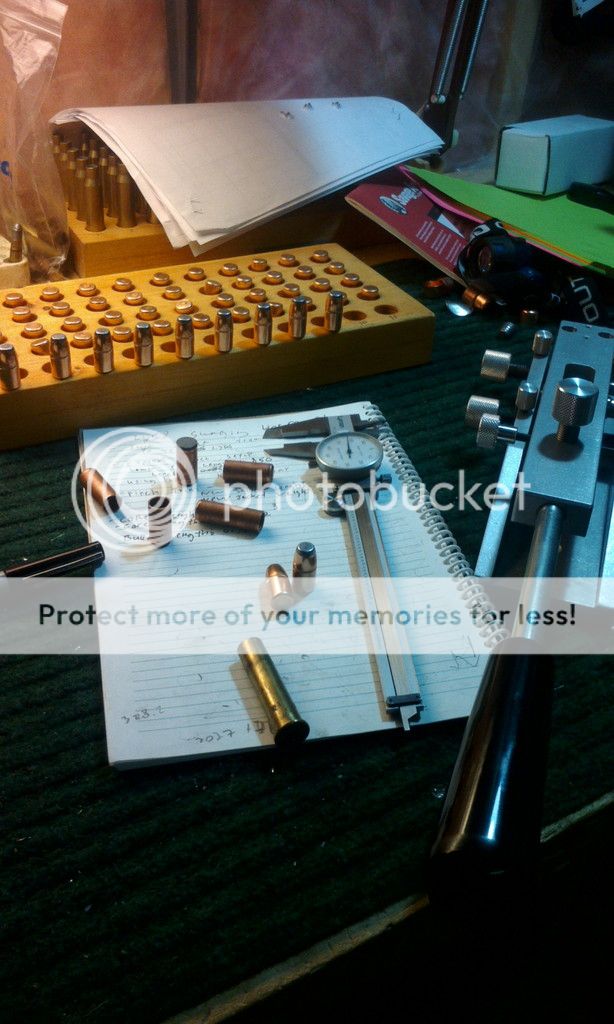

- first step determine jacket dimensions for bullet design, draw the jacket to correct diameter using a draw die which will be under 458, more closer to 450 at this point to start with.
- second step calculate desired finished jacket length after reaching 458 diameter (remember the diam' at this stage is still 450), flare the excess determined length with a flare punch and use a pinch trim die to remove the excess jacket length material. weigh the trimmed jacket, you will need this measurement for later.
- calculate the lead core needed in order to achieve final bullet weight, there is a formula to calculate lead wire diameter by length equals weight of lead.
forget about using wheal weights , scrap lead or range lead. the lead has to be at least 99% pure lead.
pure lead is consistent in weight and is soft enough to be squeezed easily without over pressuring the dies and breaking them.
the determined length of the lead core should correlate with the finished length of the finished jacket. too little lead and the nose of the jacket will buckle on itself at the end, lead core to long and you will end up with too much lead exposed or a half jacketed bullet.
cast some lead cores using an undersized core mold.
i made a simple core mold by drilling in between 2 halves of aluminum blocks 10 x 4x3/4 made 9 holes using a drill press each cavity is about 3.75 inches deep and 0.350 diameter. so each time a pop the mold i get 9 bits of pure lead wire about 3.75 inches long and 0.350 diameter.
- i cut the lead wire just a bit over my calculated length using a bench top sheet metal/ wire cutter that i got from busy bee tools and i created a length stop for it to make the process go faster.
so now i have a bunch of lead cores that are just a bit overweight.
i lubricate the lead cores using a very small amount of lanolin and i put each core in the core swage die.
i set the core swage die in the press to produce my calculated core end weight.
perfect die set up is important at this step or you will get a different weight bullet at the end.
this die will squish the lead and will expand it from 0.350 to 0.3955 and there is a bleed hole so any excess lead will squirt out the bleed hole. end results is a perfect cylindrical core in the desired calculated weight.
- next step is to remove any lubricant from the cores by rinsing them in alcohol or any substance that would remove the lube and dry fast. mineral spirits works well too.

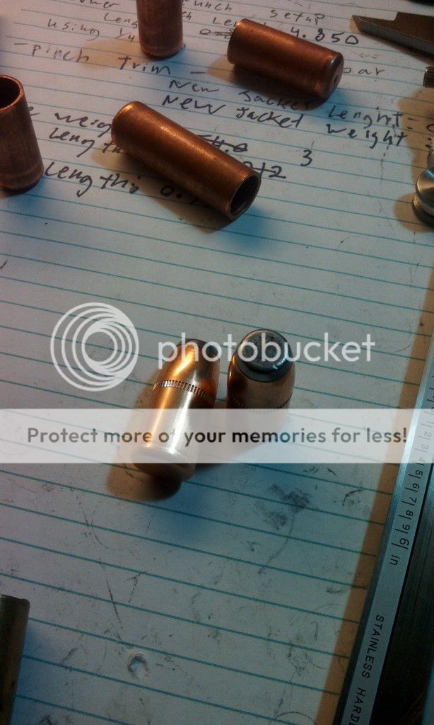

after cores are cleaned they should be a drop fit into the jacket.
place sized and cleaned cores in jackets.

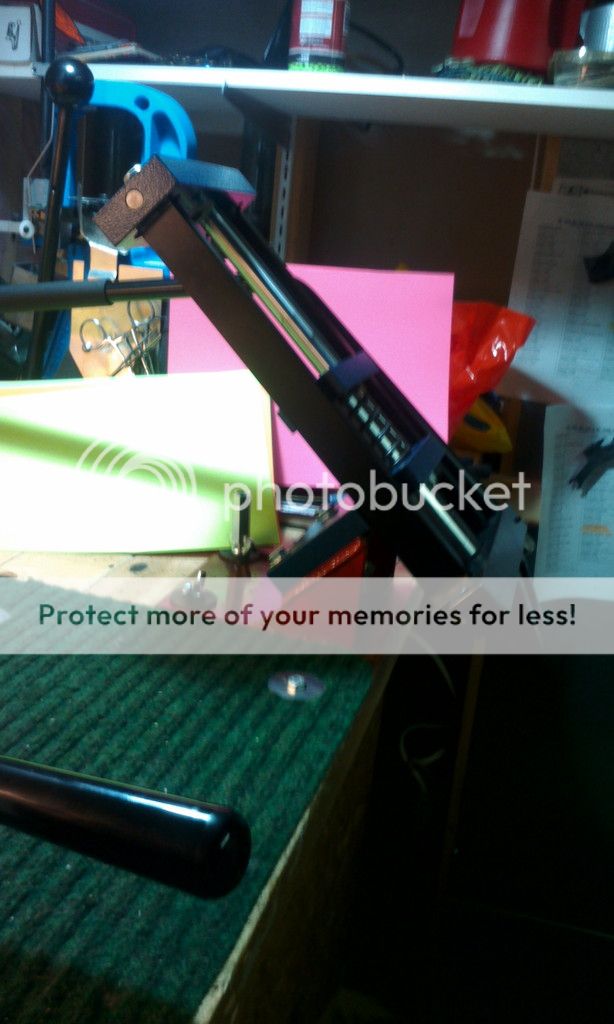

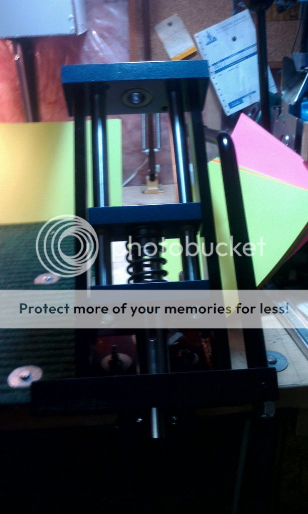

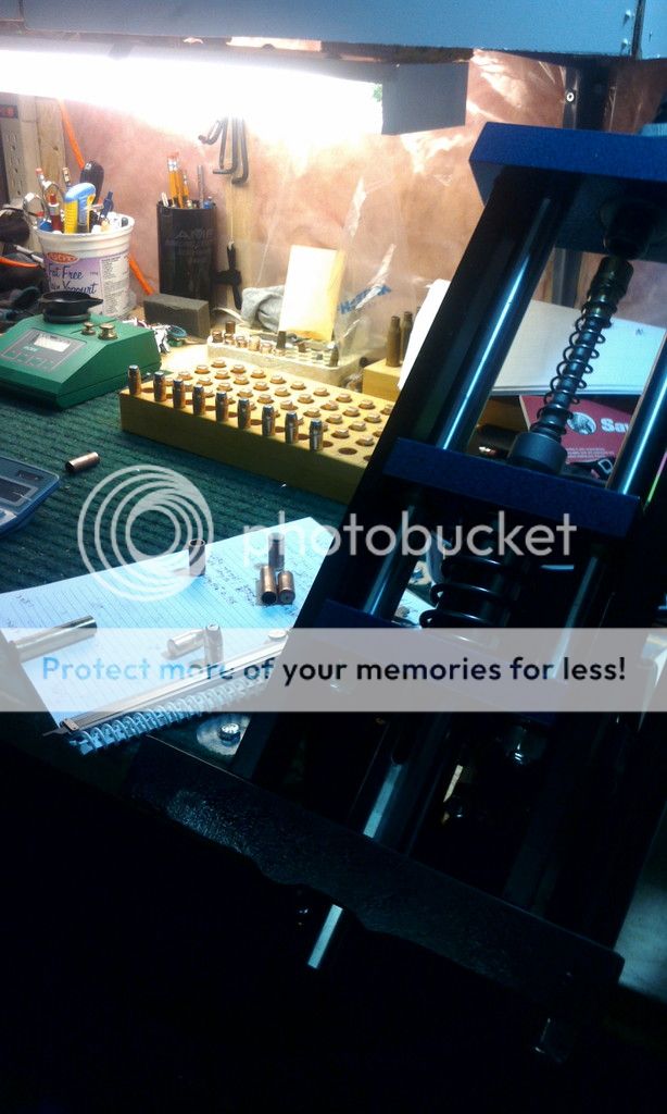

- place core seating dies and punches in the press and adjust for core seating.
apply a tiny amount of lube on the jackets.
run the jackets with the cores in the core seating die. this step will seat the core in the jacket properly.
it will expand the core against the jacket and will cause the jacket to widen up against the body of the die which is 455.
so after this stage you should have a straight walled copper tube with a lead core adhered with pressure to the copper which is expanded almost to the final diameter.
- next step is point forming. set up the point forming die in the press according to your calculated measurements and depth.
wipe a tiny amount of lube on the jacket ends (ogive) run the bullet in the point forming die.
this will squish and form the tip of the bullet and cause the lead to flow forward so if you did you math right you will end up with the lead moved forward to your calculated area on the bullet, in case of a lead nose it will flow forward beyond the length of the copper jacket, knowing the flat end of the bullet tip has a 0.205 meplat.
this die will also bring the bullet to the final diameter of 458
if you messed up you may end up with a copper tip and the lead is below the point of the bullet, well, depending what you are trying to achieve.
final step i take is placing a canulare at the calculated distance on the bullet so it can be seated and crimped to fit in a tubular magazine and clean any possible remaining lubricant off the bullet.
ok, so this is a rough explanation of the steps, there are small nuances such as the amount of pressure used to achieve cam over in each step etc' etc but this should give you a rough idea of the steps.
side note about jackets.... there are several options for jacket material. most common is using 22lr brass for making 6mm bullets and 224 bullets, i have also played around and made 458 bullets out of spent annealed 40 S&W brass. almost any caliber jacket can be made using used brass. seen guys make 30 cal bullets out of 50 bmg used primers and 338 jackets made out of 223 brass.
also can use specific copper tubing 0.035 wall thickens for making thick walled bullets which make great hunting rounds.
