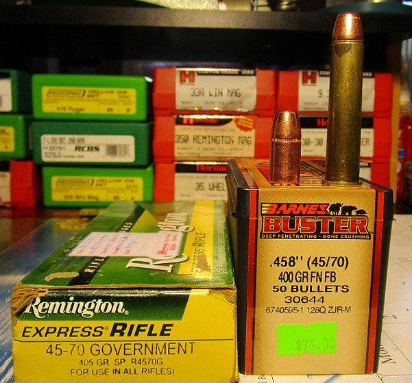

The Barnes Buster should be a decent alternative to hard cast. Quite possibly the perfect bullet for lever .45-70 livestock Bison culling. ;)
