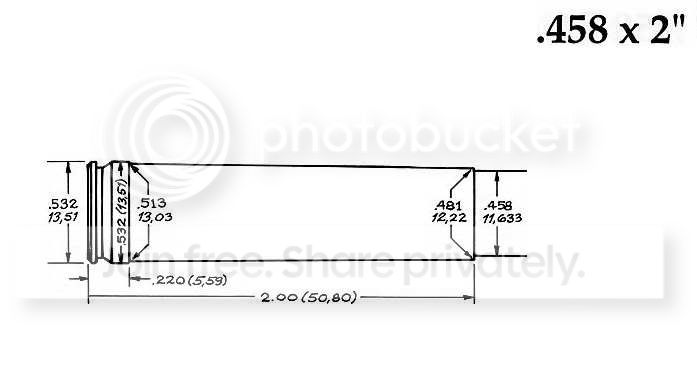

I am mistaken about the 458 American being a bottleneck case. I'll just go ahead and slap myself for that last comment. :slap:
