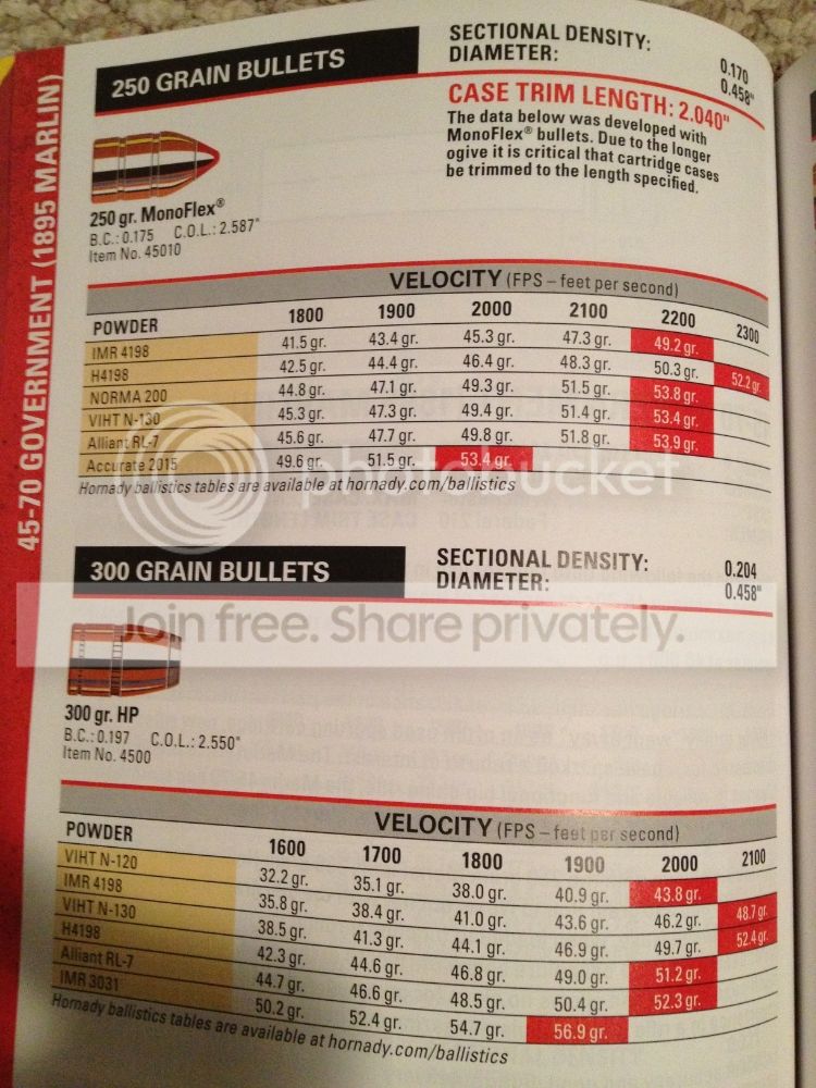

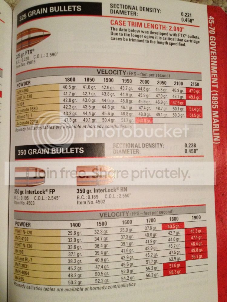

Hornady data for you. Note the trim length they suggest.
Thanks! Great to get some hard data instead of filtering it online - makes me a little more comfortable :p
As stated, the FTX bullets are quite a bit longer. In order to get them to 2.525" you need a shorter case like the Leverevolution ammunition. Compare the bullets to a 300 jhp or 350 rn/fn and you will see the difference. Now to set you seating die you would sit an empty case in the shellholder, run the ram up and turn the die down until it contacts the case. Back it out a quarter turn and begin seating a bullet, adjusting seating depth to what you want. Then back the seating plug out a turn, loosen the die and tighten it 1/4 turn at a time, running the ram up to get the crimp you want. When you have it set, lock the die down and tighten the seating plug snug on the bullet. Consistent roll crimping requires consistent trim lengths. A couple thou can make the difference between no crimp and a bulged case.
