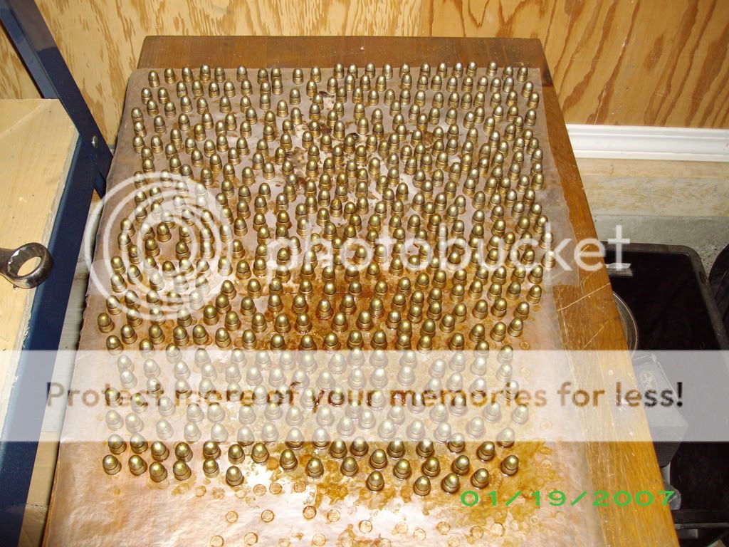

.45 bullets drying. Nothing special.
blacksmithden
EE REVOKED
25   0   0
Nothing special in particular.
Just finished the final lube on some home cast .45 bullets.
Thought I'd share a pic.

Looks like Lee liquid alox lube, it dries like a hard varnish on the bullets, not sticky at all once dry.

It gets inside the sizing die since the bullets are lubed before they go through.
Yes, it gets on my hands. Of course, since I'm in heavy equipment maintenance, I get a heck of a lot worse than that on me.
As per the previous post. It dries...thus the title of the thread...bullets drying.
Dirt doesn't stick to them once they're dry unless you throw them on the ground.
I use them in a 1911, so hunting North of the 49th parallel is kind of frowned upon.
Any more questions???? :D
Oh, and I cast for 2 reasons. I like making up my own stuff. It's a pride thing I guess. Second, it's dirt cheap....one step away from free when you cast your own.
Lee Alox is wonderful - allowing us to speed up loads and still have no leading. I use far less Alox than Blacksmith does though - experimenting convinced me that only a very very light coat is necessary before sizing and another very light coat after sizing does very well. One difference though - I use Lee tumble-lube moulds. I've recovered a lot of the wax-lube bullets with the wax still on them - showing to me that the wax doesn't get out onto the rifling even on hot loads.

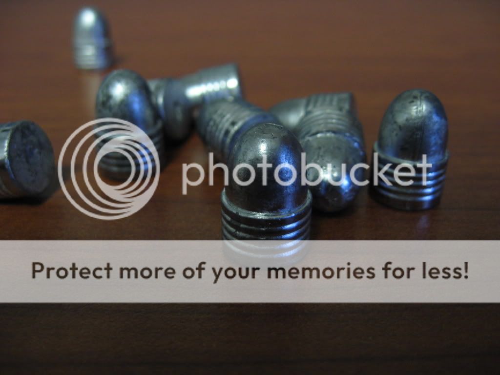

Adriel: Those two sizes sound like .45 sizes - I cast .45 TLFP and like them better than the RN. The flat point punches a hole in the paper rather than tearing a hole like a round nose. I lube a little, then size with a lee sizer, then relube. A taper crimp then assures perfect feeding. If you want to try some (if you do shoot .45,) send me your address. My 230 grain mould throws a 236 grain bullet.
