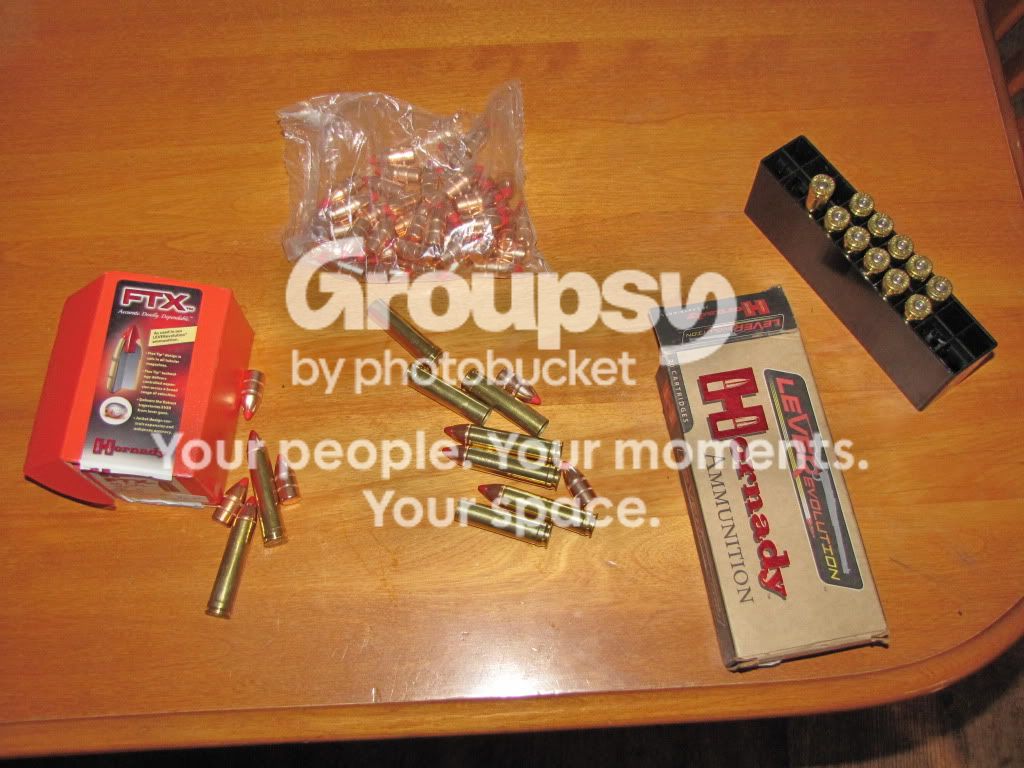

I haven't shot it alot but the 325 grain Hornady leverevolution worked good on paper.I also haven't reloaded any yet.I'm still looking for dies for it.
Found Hornady dies at BPS in Vegas.
To use the FTX pills, you need a diferent bullet seater, I ordered it direct from Hornady. Try to get the dies there too....
Cheers, G.
I own a blr in 450 marlin and plan on loading barnes tsx 300gr for it, I purchased the hornady dies and brass, I also plan on loading the hornady dgs 400gr and 500gr solid brass rounds just for fun to see how it will shoot. Gun shoots awesome with the 325gr leverlution or the 350gr hornady customs. I have looked at the buffalo bores site and wish I could get them here but I will load my own and let you know how it works out.
