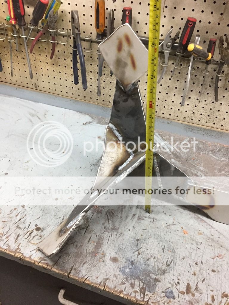

This is not a big deal for me I have all the stuff needed , welders, plasma cutter, lots of scrap steel and Stainless kicking around the studio. I knew I would need to make it pretty beefy I'm gonna my to be chucking 240-300 grn projectiles with a velocities between 1800-2000 fPS at it. So I start by laminating 3/16 mild steel plate together for the body of it and cut some 1/4 inch Stainless for the actual target disc. It's just scrap and a test so I didn't really care what it looked like.

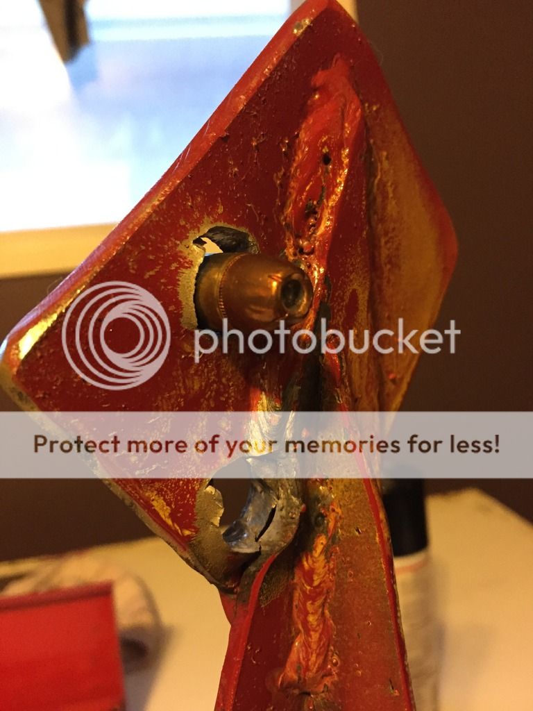

Then I went out and shot it! First at 50yds these are 240 grn hornady XTPmags over 36 grn of H110. I thought I missed on the first shot. The damned thing didn't move.
So I shot it again. Frigging thing went right through! Didn't even bent the 1/4 plate looks like I drilled a hole through it! No marking around the outside of the hole at all really. And here is a shot to show you what the cartridge looks like in the hole.
Oh yeah. That bottom hole is my second shot. Notice that it took out the 3/16 backing as well. And... where did the Stainless that was in the hole go?!! That .452 bullet just passed through a 1/4 inch of Stainless leaving an almost perfect 1/2 inch hole.

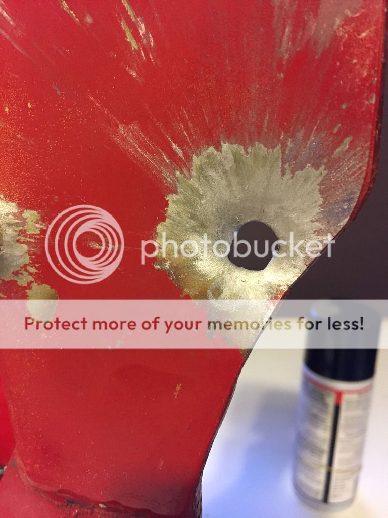

So I took it out to 80 yds and shot it.
This was done with a FA 260 grn JFP(jacketed flat point for any that don't know). At least it bent the Stainless and broke up a bit. It didn't eat the Stainless either. Just shoved it out of the way.

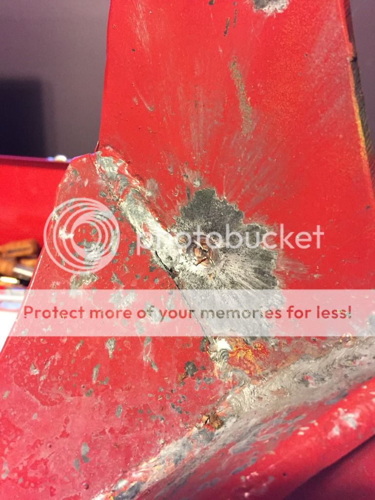

This last shot was one of the XTP mags at 80. It hit right next to a gusset and on a part that is two layers of 3/16 mild steel. This definitely moved the target tho!

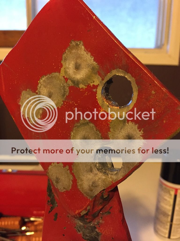

All the little marks you see are .22 lr I was playing around with it after I decided not to totally destroy this target in an afternoon. Maybe it will work for the .308. Lol.
