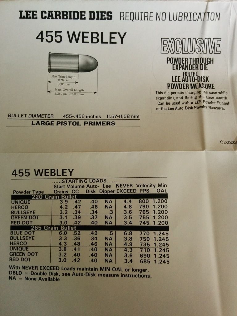

Hello I am looking for some load data using IMR powders. The powders that I have are 3031 4895 4350 4227 and 4198. My bullet is a 265gr .454 thanks for the help.

The Lee data has been heavily sanitized by their legal section, probably due to the age and condition of some 455 webley revolvers.
Occasionally you'll read advice to "work up a load" in these antique revolvers, and that can be misleading. Max pressure for the antique 455 webley revolvers is about 13K psi. There will be no pressure signs except possibly primer extrusions on sloppy firing pin channels at anything under 20K psi or more. Don't depend on fired brass to tell you when you're approaching maximum pressure. The first "pressure sign" could be your revolver coming apart. A chronograph is a good investment.
