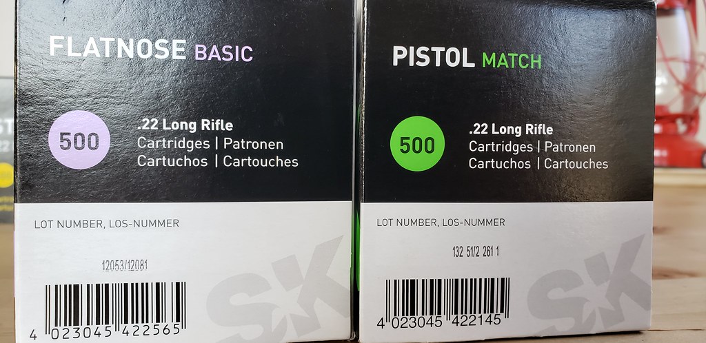

Tenda now sells some SK ammo - Standard Plus, Pistol Match and Flatnose Basic. Enjoyed a Christmas week at the cabin shooting all day long and tested each ammo out of my 457 MDT. The CCI SV will be my go-to plinking round but of the SK ammo the Pistol Match came out on top with the Flatnose a close second followed by Standard Plus. I just came back from Tenda and bought a few thousand rounds of the Pistol Match to keep aside when the need arises.
Using my FX Radar these are the results from my 16" barrel; Pistol Match averaged 1050 fps, Standard Plus averaged 1084 fps and the Flatnose Basic averaged 1084 fps.
For what's it worth and hope this helps other CZ 457 owners find decent ammo for their rifle. The conditions where not perfect during my test but good enough to satisfy my test findings. Distances were 25 yards, 50 yards, 67 yards and 100 yards.
Set up was a front bipod and rear bag. Measured edge to edge and minus 0.223"
