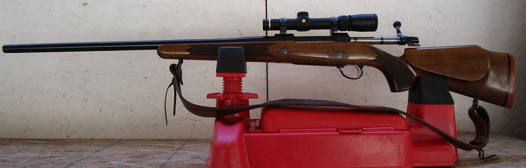

Remington 798 458 Win. Mag. with Leupold FX-II Ultralight 2.5x20mm
