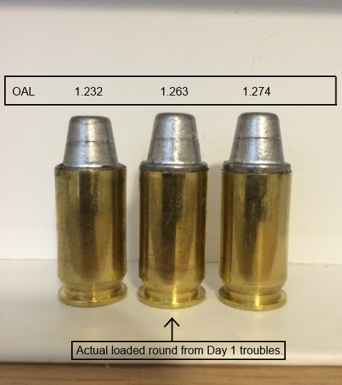

to get consistent uniform crimping from round to round, the brass cases must be identical length. uneven crimping tension will affect velocity and chambering.
Trimming pistol brass is useless.
first off. ALWAYS worry about. O.A.L. for the .45 taper crimp. the idea is to adjust your die untill it takes away the case bell, then give it another 1/4 to 1/2 turn. load it up. do a plunk test. or load up a blank (no powder, no live primer, just an empty case with a bullet) load it in your mag make sure it feeds like it should without hanging up or anything. then you should be good to go.
A 1/4 or 1/2 turn, eh? I find case mouth measurements more precise, a .471 taper crimp generally gets it done.
