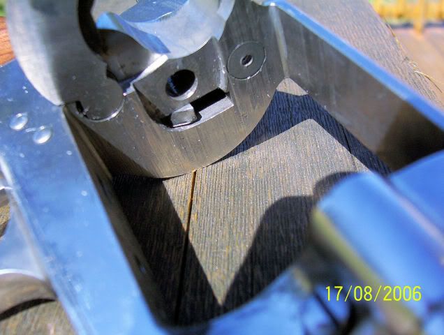

One thing I forgot to mention about my Pietta. The inside facings of the frame, the recoil shield, under the top strap, and the bottom face, all look like they have been finished with a rough file. Assembled, the look of the gun is of a very nicely finished weapon. Take the cylinder out and it is quite a shock to see the very poor finishing. If I get a chance today I will post some photo's.
TJ

Machine marks on Pietta frame

I really don't like the edge of primer strike, could be nasty if the primer was sensitive. I can reproduce the skipping on the Pietta, but just can't make the Uberti's misbehave at all. Funny, you would think that the actions were the same.
The Pietta action is smooth, but rather vague. The Uberti action is coarser but very positive.
I like them all, but can't use the Pietta as a main match gun. It's just the back-up should one of the Uberti's break.
TJ
