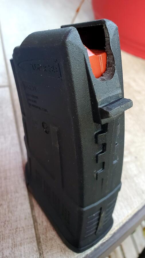

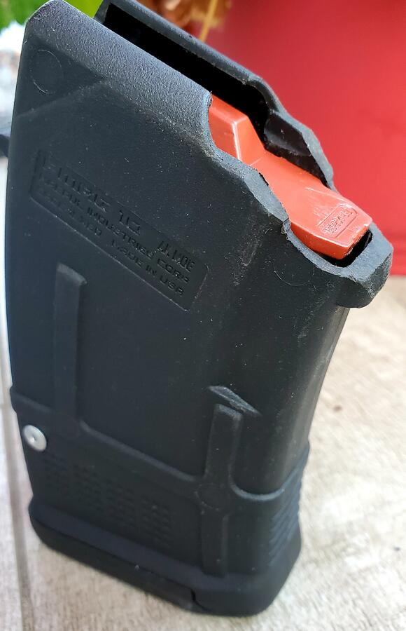

The Croatian/Romanian AK mags needed hardly any material removal. The Pmags were a bit more involved. I'm a Bubba at the best with a Dremel and I figured it out.
Actually thinking back on it, I used a belt sander on its side to change the feed lips profile on the Pmags.

Here's a couple of pics of what I had to trim to get the Pmags to work. Bubbalicious!

that is great but a few of us were worried about the strenght and durability. i do know that some metal mags got an hard life and still running and i do not know if those will have done the same at all in the same conditions, but thanks to show what can be done. i imagine yours are now $110 ... lol
