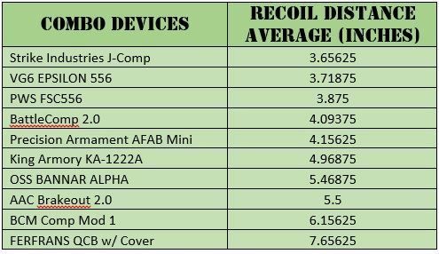

Recoil Testing
First, a quick note: not all of these muzzle devices are brakes/comps, or were otherwise designed to mitigate recoil. For some that is the primary goal. Aome balance recoil management with flash hiding, and some have no recoil reduction consideration whatsoever (e.g. dedicated flash hiders or a linear compensators). For most brakes and comps, felt recoil reduction is only one goal anyway, with the other primary benefit being the reduction of muzzle movement in any other direction. The slow-mo footage for each device in the following video does show some noticeable differences in up/down muzzle movement as well as flash, but this test was specifically designed for measuring recoil — rearward energy.
Keep in mind that we’re also talking about the fairly minor recoil of .223/5.56 here, and many prospective purchasers will put recoil reduction at the bottom of their list behind other considerations like reducing flash and concussion.
With my gas piston AR-15 strapped in a rest and the gas block turned to “off,” which means the action remains locked shut and 100% of the gas going out the muzzle, I proceeded to “sled test” all of the muzzle devices plus control measurements of the bare muzzle and a standard A2 birdcage. The results were surprisingly repeatable and consistent. In fact, the average of the extreme spreads — difference between shortest and farthest result — for everything in the test (including bare muzzle and A2, which were the least consistent of all) was only 0.1943 inches. Seven brakes did multiple shots with the exact same result each time.
For the record, I measured in 1/16-inch increments and chose not to round when converting that to decimal measurements later.
With all of that said, our recoil reduction winner is…drum roll please…
Precision Armament’s M4-72 Severe-Duty Compensator!
With this bad boy on the muzzle, the test rig slid back an average of 2.4375 inches. With the A2 on, it slid 8.4375 inches. That’s a 73.84% reduction for you folks keeping score at home.
I was going to force y’all to watch the video to see the results (you know, I make like three cents every time the video ad is clicked), but I couldn’t bring myself to do it. Also, thanks to TTAGer NotoriousAPP’s awesome data skillz and willingness to help out, we have not only my boring tables but also some cool charts to show as well.

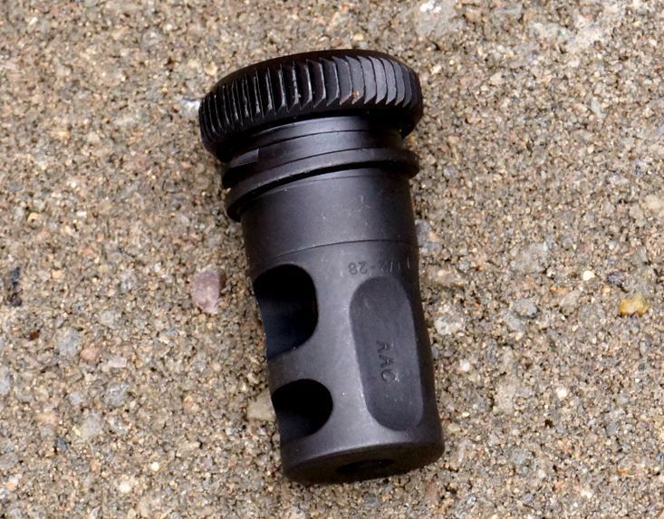

AAC BLACKOUT 51T Muzzle Brake:
Clean machining and a low gloss nitride finish make for an attractive brake that doubles as a fast-attach mount for AAC sound suppressors. It’s a good looking and effective two-chamber brake. Plenty of fire and side concussion. If one has no use for the suppressor attachment feature and isn’t drawn to it for its unique looks, there are smaller and lighter options. Also available for 7.62.
Material: 17-4 Stainless Steel
Finish: Nitride coated
Length: 2.025″
Diameter (at largest point): 1.136″
Weight: 3.59 oz
MSRP: $150USD

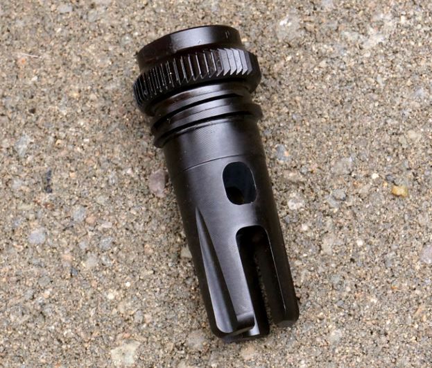

AAC BRAKEOUT 2.0 Compensator:
The BRAKEOUT is supposed to combine the best features of a conventional muzzle brake along with excellent flash suppression. It’s sort of a single-chamber brake but, instead of a port on each side, it has three small ports. Each is angled rearwards and matches up with one of the gaps between the three flash hiding tines. Machining is very crisp and precise, and the finish looks great (it’s either a higher gloss nitride or AAC’s “SCARmor”).
AAC says it’s “the best of both worlds in a truly compromise-free design,” and I think it looks great but it was far from the best brake and both slow-mo shots showed some fire and flash. It also does “tuning fork” just a little bit (the tines ring). Also available for 7.62.
Material: unknown (AAC website doesn’t state)
Finish: unknown
Length: 2.677″
Diameter (at largest point): 1.139″
Weight: 4.625 oz
MSRP: $125USD

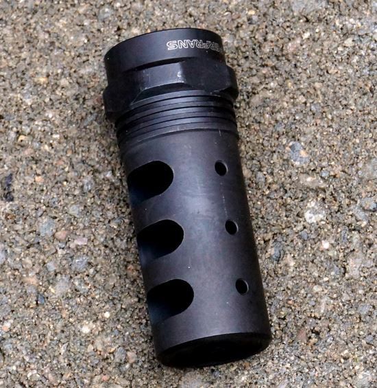

FERFRANS CQB Modular Muzzle Brake plus CRD:
This system from FERFRANS combines a 3-port muzzle brake with their quick detach CRD, or Concussion Reduction Device. Run the bare brake when you’re looking for the best recoil and muzzle rise compensation, and add the CRD when you want to direct the concussion and blast forwards instead of sideways at those around you. As you can see in the photo above (also click here and here!), directing everything forwards doesn’t equate to reducing flash. May be handy if you want to kill and cook your game at the same time. Machining is good, finish is good. The CRD is easy to pop on and locks securely.
It also fits and locks onto two other muzzle devices in this test, both from Strike Industries (which does sell the FERFRANS system). As I can’t find any info on this unit on FERFRANS’ website, we may as well link to the product page on SI’s site. That said, it’s available from a handful of other well-known retailers in the U.S. if you have a different preference.
Material: unknown (appears to be carbon steel)
Finish: unknown (I’d guess parkerized or black oxide on the brake, a Cerakote-like coating on the CRD maybe)
Length: 2.275″ w/out CRD, 2.315″ w/ CRD
Diameter (at largest point): 0.972″ brake, 1.608″ CRD
Weight: 3.64 oz brake only, 10.25 oz brake + CRD
MSRP: $179.95

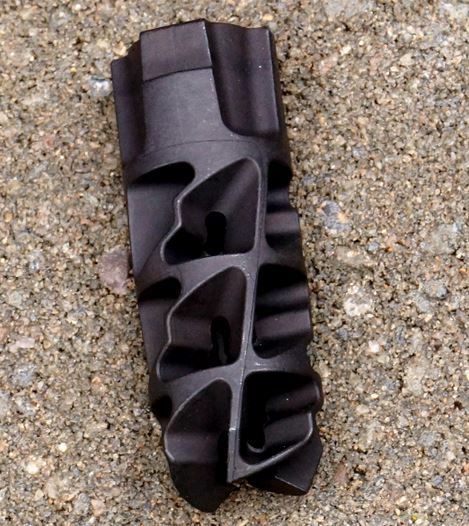

HERA Arms Linear Compensator Gen 2:
The first of two linear compensators from HERA Arms (< that link is to the manufacturer, the one in the title is to their primary distributor and retailer, LAN World), the Gen 2 is a fairly large unit that does a great job of preventing any sideways or rearwards blast and concussion, and directs noise forwards as well. The interior design is pretty cool, with a large blast chamber and a front baffle with longitudinal ports milled through it. As you can see in the last photo above, it probably looks its best when partially inside of a handguard. It could be a sweet option for permanent attachment to a short barrel in order to bring it up to the 16″ minimum while running an extended handguard without worry of singed digits.
Machining is very clean other than some minor nicks in the edges of the exterior ‘waffle’ pattern. Finish is fairly even and looks good.
Material: 41.40 tool steel
Finish: unknown
Length: 3.55″
Diameter (at largest point): 1.22″
Weight: 7.25 oz
MSRP: $149.99USD

VG6 Precision EPSILON 556:
VG6 Precision’s EPSILON 556 and GAMMA 556 (below) are very similar in design, but the EPSILON gets flash hiding prongs while the GAMMA ends more abruptly. The performance out of these brakes is fairly incredible considering the light weight and small size. The GAMMA even made Nick giggle in the video part of this review.
On the machining and finish front, these two pieces from VG6 are possibly my favorites of all of the ones here. Completely flawless on both fronts, and the photos on VG6’s website simply do not do them justice (nor do mine). This BLACKNITRIDE is absolutely beautiful, and the satin finish gives it a depth of inky blackness that I dig.
Material: 17-4ph heat treated stainless steel
Finish: BLACKNITRIDE, satin finish (also available in bead blasted stainless and matte black nitride)
Length: 2.21″
Diameter (at largest point): 0.866″
Weight: 2.48 oz
MSRP: $94.99

Recoil Testing
Length: 2.025″
Weight: 3.59 oz
MSRP: $150USD
Finish: unknown
Length: 2.677″
Weight: 4.625 oz
MSRP: $125USD
MSRP: $179.95

An extremely solid performer with an asking price under $30, the J-Comp is a freaking steal. The design is inspired by the muzzle brake on the Japanese Type 89 assault rifle. It looks pretty clean on an AR, as it has a nice diameter (body is 0.77″) and a simple enough design to look a bit like a continuation of the barrel itself. Smooth machining and standard parkerizing.
The J-Comp didn’t do a lot for muzzle rise, but it tied for seventh place in the recoil test with the cover-free FERFRANS 3-chamber piece. That’s a 60.48% reduction in recoil as compared to a bare muzzle, all in a brake that gave me no flash signature (click here and here). In fact, it just beat the PWS 556 in recoil reduction and in my admittedly limited testing it was significantly better for flash suppression. It has a pin hole for permanent attachment and is long enough to extend a 14.5″ barrel to 16″. All for like $31.95 shipped.
Length: 2.21″
Weight: 2.48 oz
MSRP: $94.99
