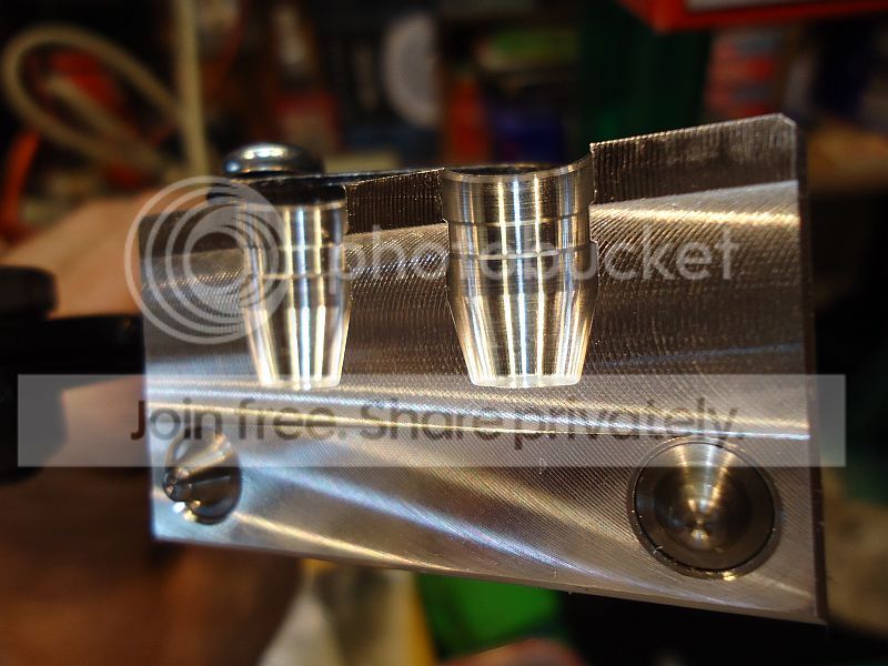

the size of the lee mold isn't a problem when you run your pot with a PID controller, i've had no issue with my new style and older style 440gr bullet. here is the older style with the alignment pins on the bottom
vs the new style,
