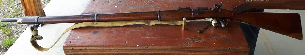

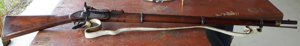

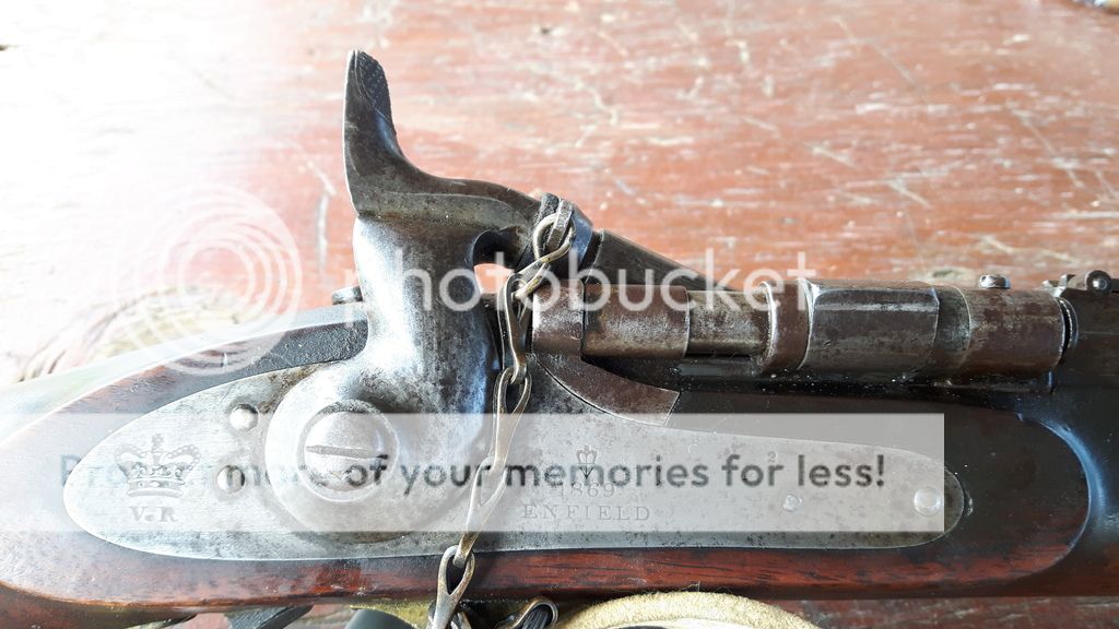

I have an 1869 Snider-Enfield that I bought from a friend a few years ago. After having reloaded for it finally, shot it and found it exceptionally accurate (5/5 shots at 100 yards on an 8" square target!)
I would like to learn as much about it as I can and I hope you friendly folks can assist me in that. I will upload pictures to assist in explaining and recognition:

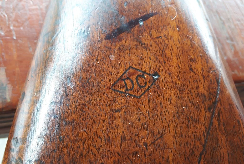

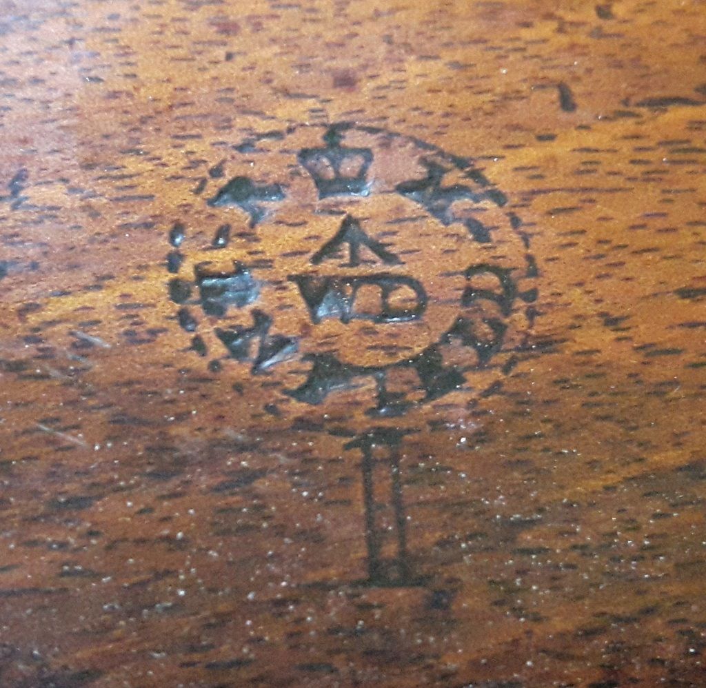

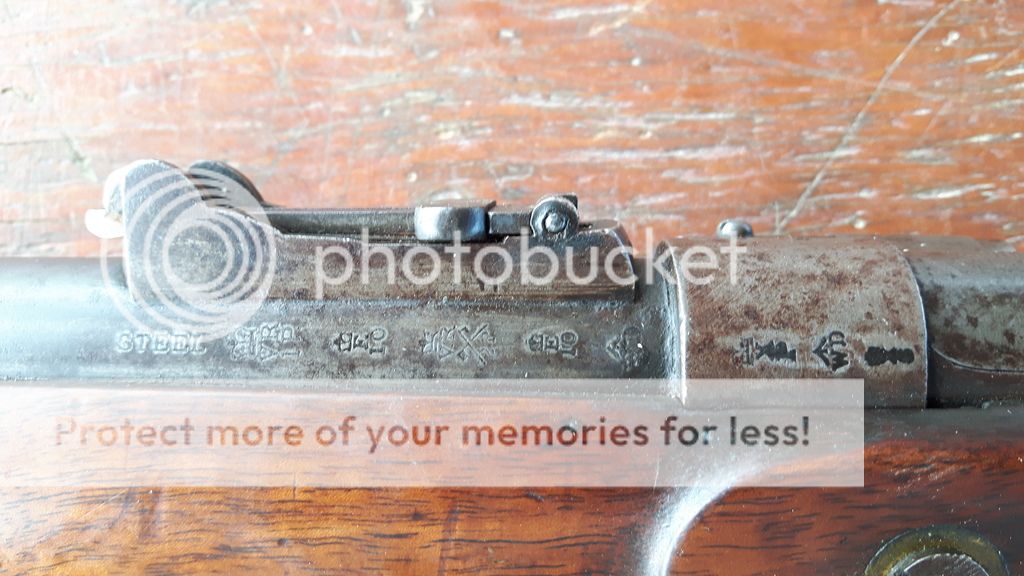

Firstly, my friend told me it had been in his family for at least a generation. The quality and completeness of it certainly shows it has stood the last 148 years well! He also said it was very, very rare: A Canadian Broad Arrow Marked, DC Marked, Canadian Unit Marked, Mk.II** With A STEEL BARREL. He says exceptionally few Mk.II's were mated in Canada by skilled armoursmiths to Steel barrels, instead of being mated to Mk.III actions due to some kind of accuracy issues with those?
So, what I am looking for:
Tracking down the unit markings (which regiment, where etc, possible rifle saw action in Rebellions?)
Information on markings, and verifying exactly what I have.
Pictures are below, help would be very welcome!

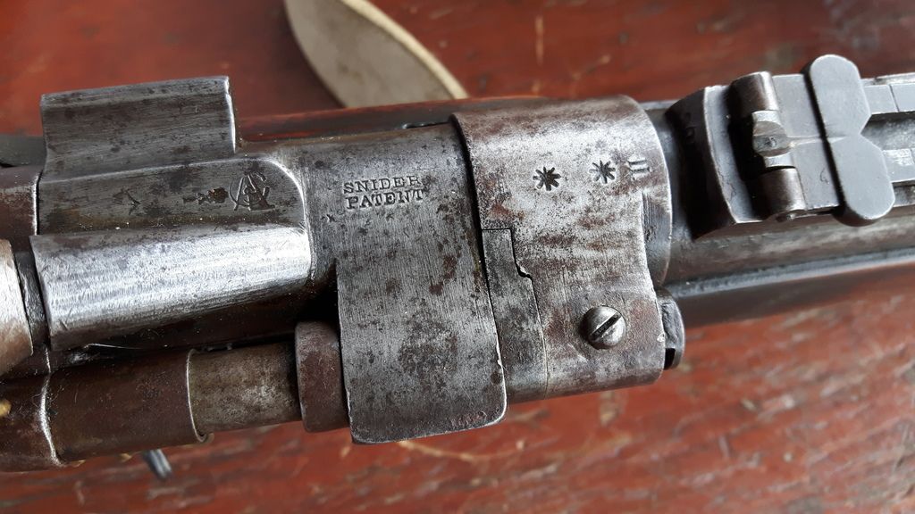

I notice that your rifle has the early form of breech-block, devoid of the later push-in latch. That strikes me as rather odd on a gun with an 1869 lockplate.
tac
Tac,
I agree on the breech block, apparently it is a special "peddle scheme breech block, fitted to some Canadian rifles with early steel barrels.

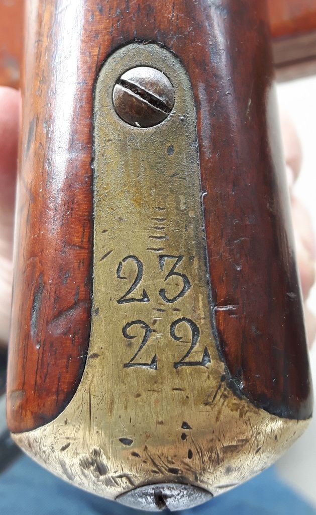

The unit markings are kind of oddball since if a rifle was issued to another unit the early stamps would often be "X'ed" out. Also many units used a number/letter designation. I'm assuming there's no unit initials on the rifle stock or butt. That said, according to my "Handbook of Identification Marks on Canadian Arms", "22" could be the 22nd. (Canadien-Francais) Btn. and "23" could be the 58th. Westmount Rifles, Montreal Btn. Interesting that both stamps are from Montreal. Did your rifle come out of Quebec at some point?
23 is 23rd Battalion St Marie Que, in 1885 it had authorized strength of 185 in 4 rural companies in 1885.
The shoe and breech block are made by London Small Arms Company, LSA Co entwined on block and X P inspector mark of LSA on the shoe. LSA was one of the civilian contractors which converted P53 MLs to Sniders.
The barrel bears Enfield inspector marks ,crown E 10, indicating it may have been rebarreled.
Never heard "peddled scheme" used in relation to Sniders.
The bore of the Snider is .577" parallel from breech to muzzle. The grooves taper in depth from .012" at the breech to .007" at the muzzle. If you slug the bore from the muzzle you will get a reading of about .590". The groove depth at the breech is about .600-.602". You need a bullet of .600" to seal the grooves at the breech.
Newly manufactured Mk III's had barrel marked with 1P and 2P (proofing before and after mating with shoe). The shoe on these would only have the 2P. The proof on the shoe on this rifle is of the type used on converted rifles so I suspect this rifle was merely rebarreled in service by an armorer using a steel barrel salvaged from a Mk III. An interesting one for the collection.

23rd Beauce Battalion of Infantry (St.Marie, PQ,,,,in 1869 then as the 23rd Battalion in 1871)) or
23rd Essex Battalion of Infantry (I doubt, Windsor, Ontario, formed 1866, disbanded unofficially 1868 and officialy 1870)
23rd Brockville Battalion (I doubt, formed in 1863, disbanded in 1866)
My money is on 23rd Beauce - 23rd Battalion of Infantry.
I have two marked 23rd
1st was 23rd Essex and later stamped the 29th of Waterloo
2nd was 23rd Beauce Battalion and then onto the 17th Levis Battalion
Looks like a new barrel - re-barrel long ago to me, I'm not sure at Battalion Armorer's level, but a Depot Armorer's level which would be in Quebec at the time.
Nice piece of Canadian History!
